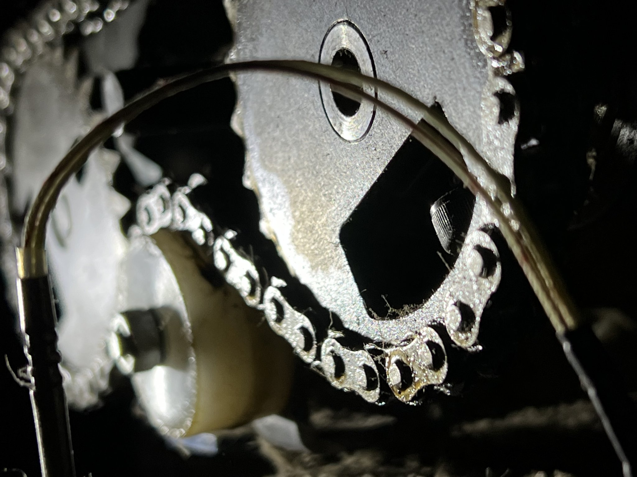

For what it’s worth, this is the auger/pellet feed drive chain in the guts of my pellet stove. Lotsa dust and dirt in there. Two blowers running 24/7 within inches.
Lubed it a year ago with Fluid Film. Still pretty clean and slick. Not a great picture.
With some other lubes, you couldn’t identify the chain very well. Coated with dirt. Had to wipe it off to lube again.
Figure if it works there, should work on a PTO shaft…
