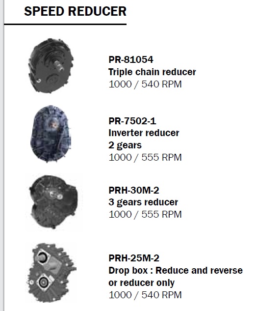

Companies like Pronovost Snow Blowers sell these gearboxes for extra large tractors so that their 1,000 rpm pto's can be lowered to 540 rpm.
If you explained your need in some detail perhaps more useful advice can be provided.
If you are trying to make your own "Economical" pto for your tractor, for smaller machines it typically does not work because you are needing more torque than is available on the engine torque curve at lower engine rpm;s.

Yea what are you trying to run with it?
You lose a ton of HP with a multiplier, most of the time making it really unusable, and on a B2650 your not going to have much left.
