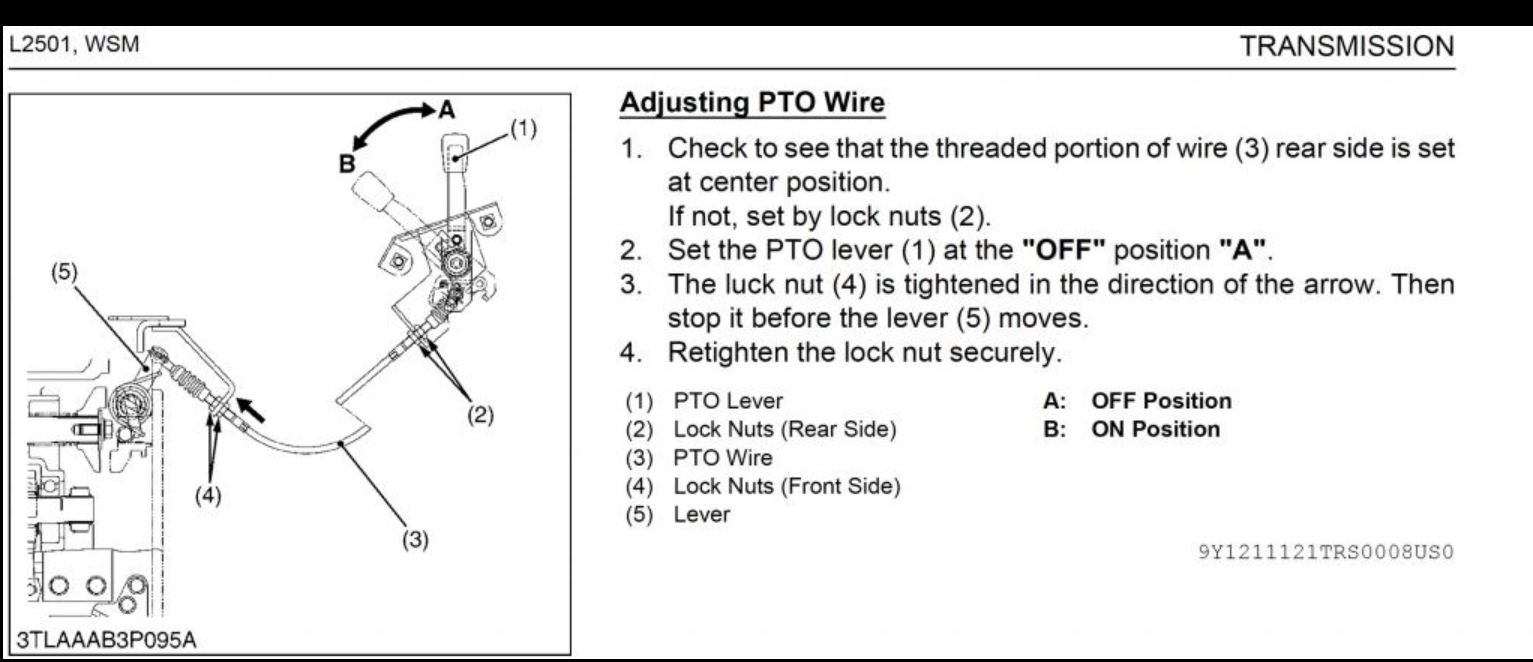

I found this (it is for HST however - does this shed any light?)
OR THIS

i have an HST L2501. This issue is common though never had the lever stick but the cable in the housing. Get some lubricant with a nozzle “straw”. Put the straw where the cable goes into the shielding. And spray liberally. Go to opposite end and spray up that end too (not easy to access). Let it set then work the lever.

Gear models don’t have a cable operated pto…
spin the pto shaft and retry to engage the pto…

Oops! I read OP’s and then someone mentioned HST and I got off track. Sorry.
