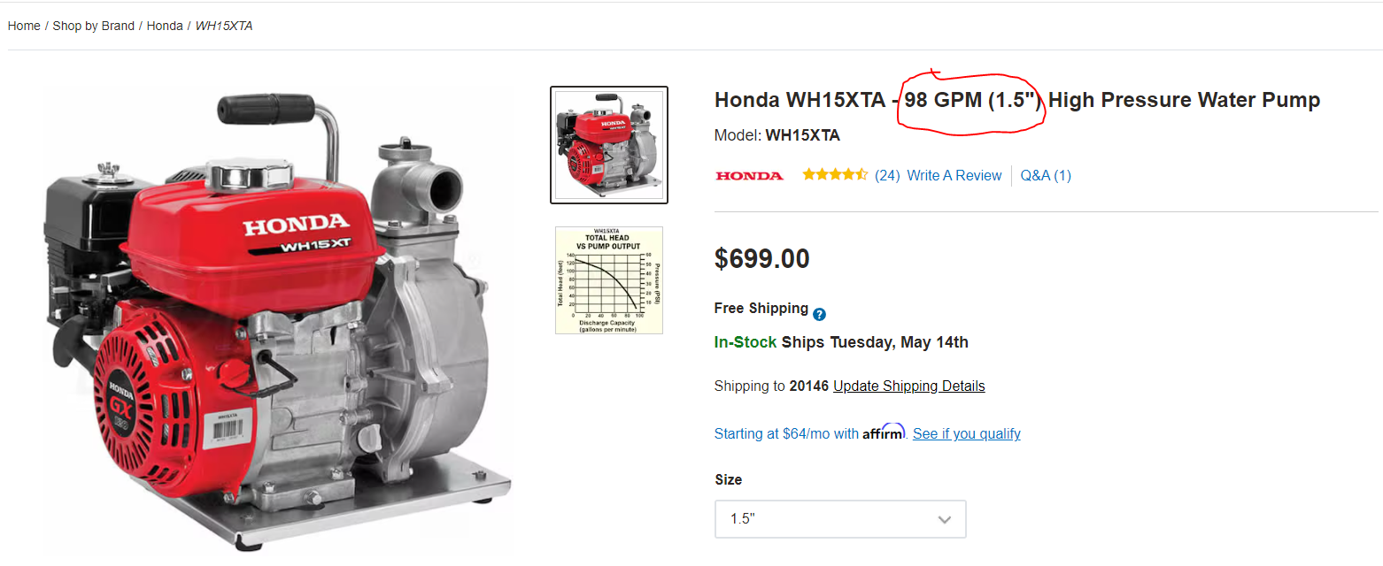

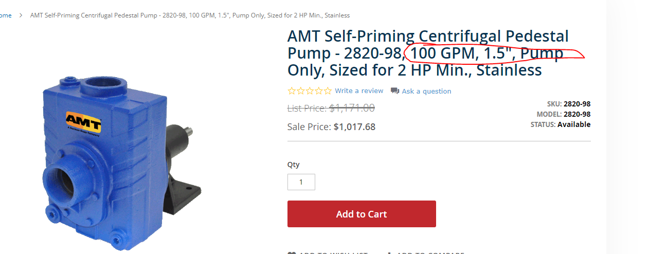

Curious - would a stand alone be cheaper than a PTO driven one?
And would you want your tractor tied up for the duration of pumping?
I too would recommend a stand alone gas powered pump!
Much more versitile, and can be easily sold if/when no longer needed.
Probably cheap at HF.... but, buy their 2 yr warranty!
