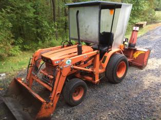

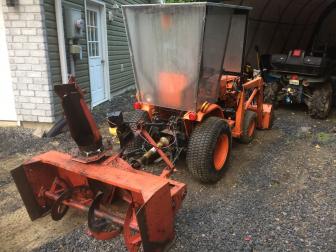

I’ve operated a few tractors but now I’m an owner of a B6200 not sure of the year. I’m (supposedly) Be only the third owner. Guy I bought it off said a 1991 but he also said it was meticulously cleaned and maintained! Haha. The serial number is 62388 to me that’s a ‘88 but I dunno. He also said that it had low hours, 200hrs I laughed. It would have gathered more idling over the last thirty years! Who knows how many times it rolled over. Anyways the negative stuff is out of the way, I’m happy with my purchase, have leveled out a few piles of gravel so far with it. Bought it primarily for the blower on the back. Just wanted to say HI to everyone on here and all the best!
Has anybody put engine gauges on these tractors before, I hate to rely on idiot lights and I’m told there is a whistle in the rad. Vent line for overheating!
Thanks for any advice
Couple pics of my new ride below.

Looks like the cab is in serious need of some new windows! :eek:

Also going to put handcrank window wipers on it lol the windows were all dew that morning I took the pics!

the plexi glass seems a tad faded. I like to see what I'm doing. I'd change that before cold weather sets in. But that's just me.
