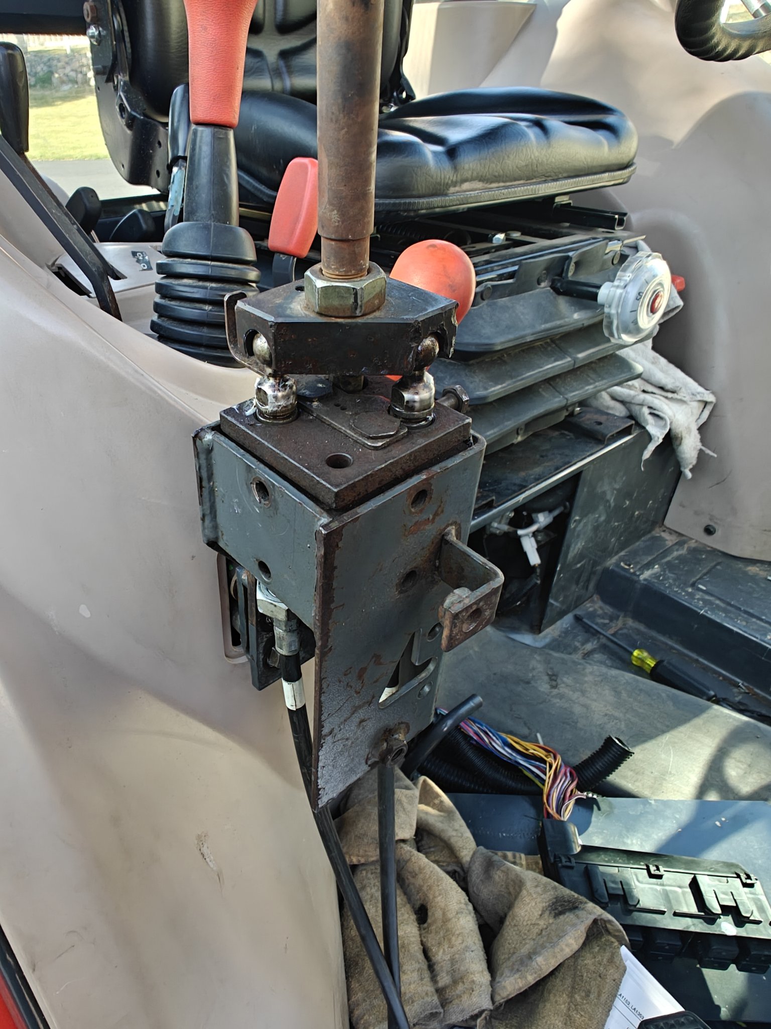

could anyone possibly post a picture of the proper position of the control mechanism on the joy stick. Not totally sure I have it in the right position and the manual is no help on how its installed.
Thanks
Thanks
DJ
i can't say your connections are the same as my b2100 ?, but !!..i did have this issue with my bucket not curling once i had all the lines connected. my problem was the bucket was not working correctly when using the joy stick ?, come to find out..i had the two lines coming from the hydro line that leads from pump to rear hydro area backwards ?!. once i swapped these two lines around, now everything works correctly !. sooo...where ever your joy stick gets its hydraulic fluid from ?, check to make sure you have those lines in the correct spot coming off the line ?!. this pic clearly shows the correct routing of the lines to joy stick, i had the two lines backwards from the diverter block, swapped them, everything works great now.

Any thoughts on this one. I would still like a picture of someones remote station to see if I'm in the right location.
