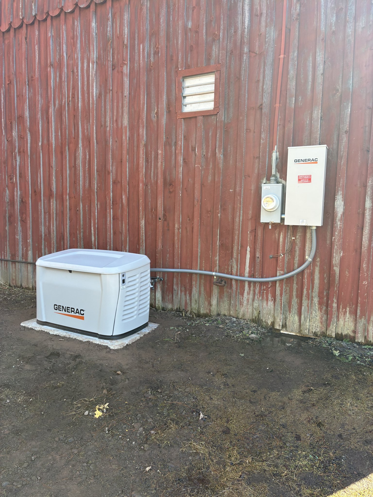

Had a stand by generator installed. Generac 15KW 60amp, can’t run every thing in my shop but it will run the house and most of my shop. Power goes out for a few hours or days we can go about life normally for the most part.

Propane, we already have two tanks (500 gal each) there for heat, our plumber just hook up to them.
