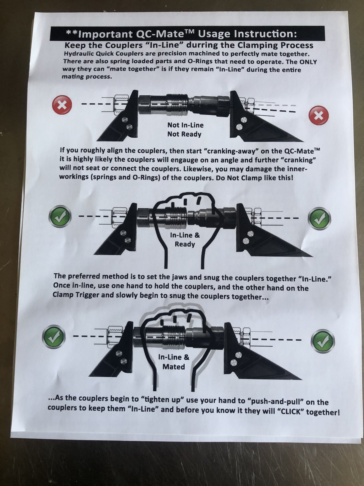

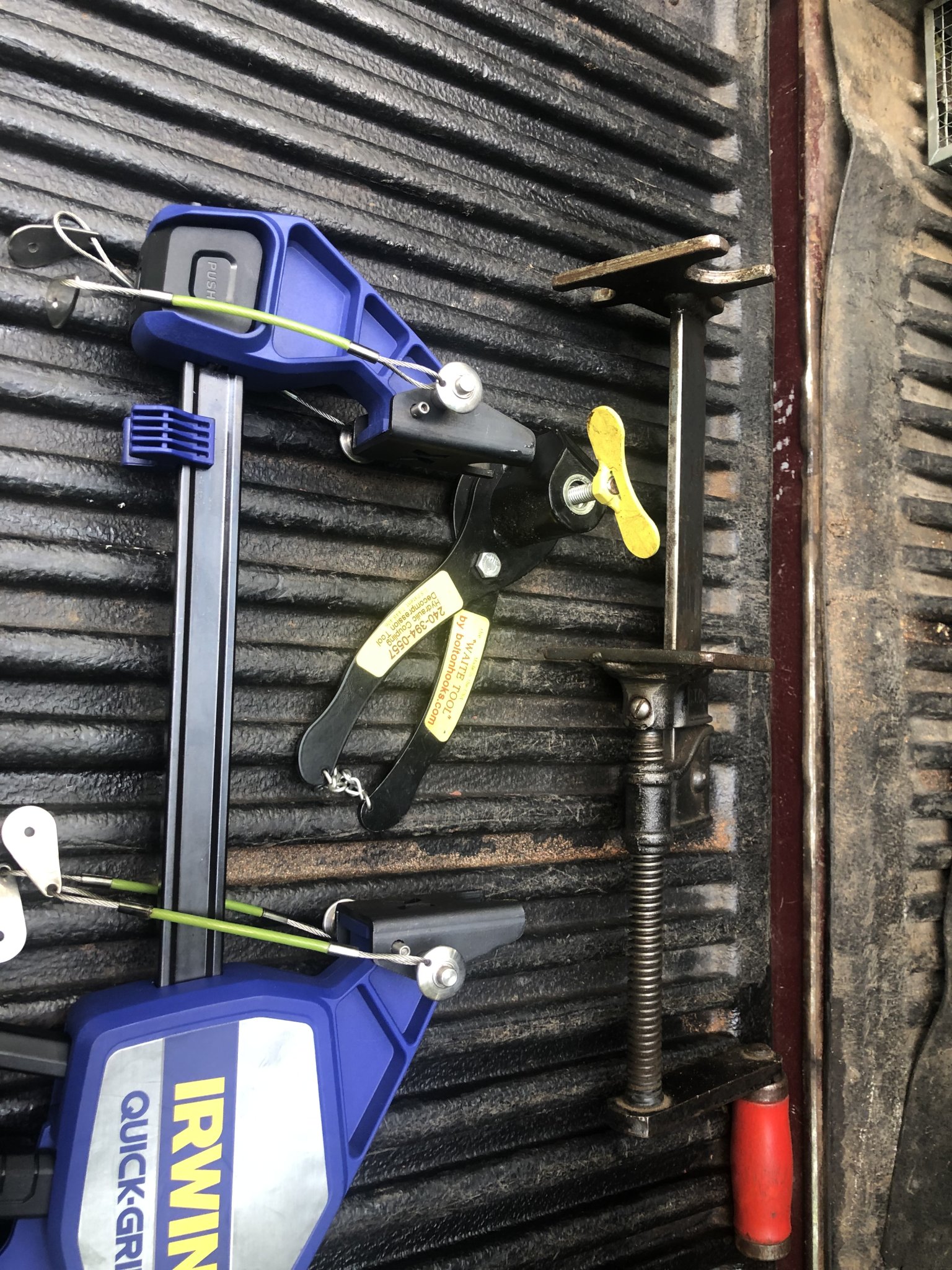

Older tractor equipment used agricultural type quick connectors. Not as easy to keep clean but easier to decompress. Gear tractors very tolerant hydraulic contamination. Construction equipment lead the flatface type QD, easy to wipe clean and better for hydraulic drive transmission. Also compliant to fluid loss on construction sites.
Most of my equipment is now converted to flatface QDs. Techniques described help connecting 95% of the time. I’m not as big of a gorilla as I once was so tools help too. Homemade or store bought.
