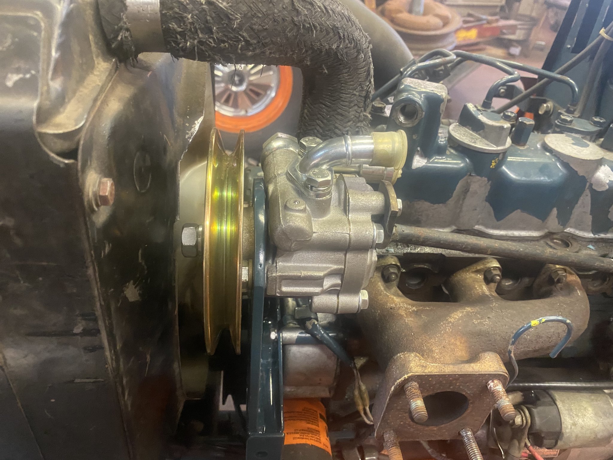

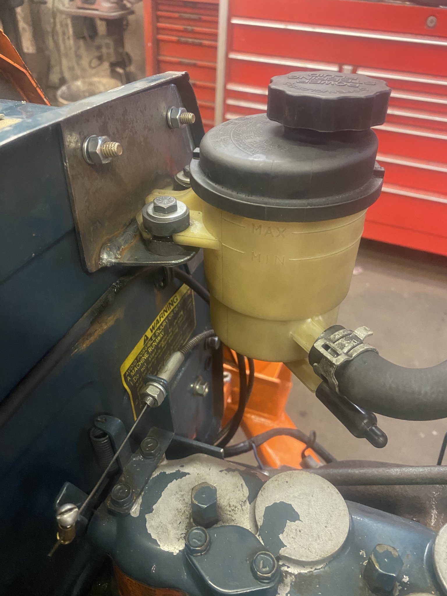

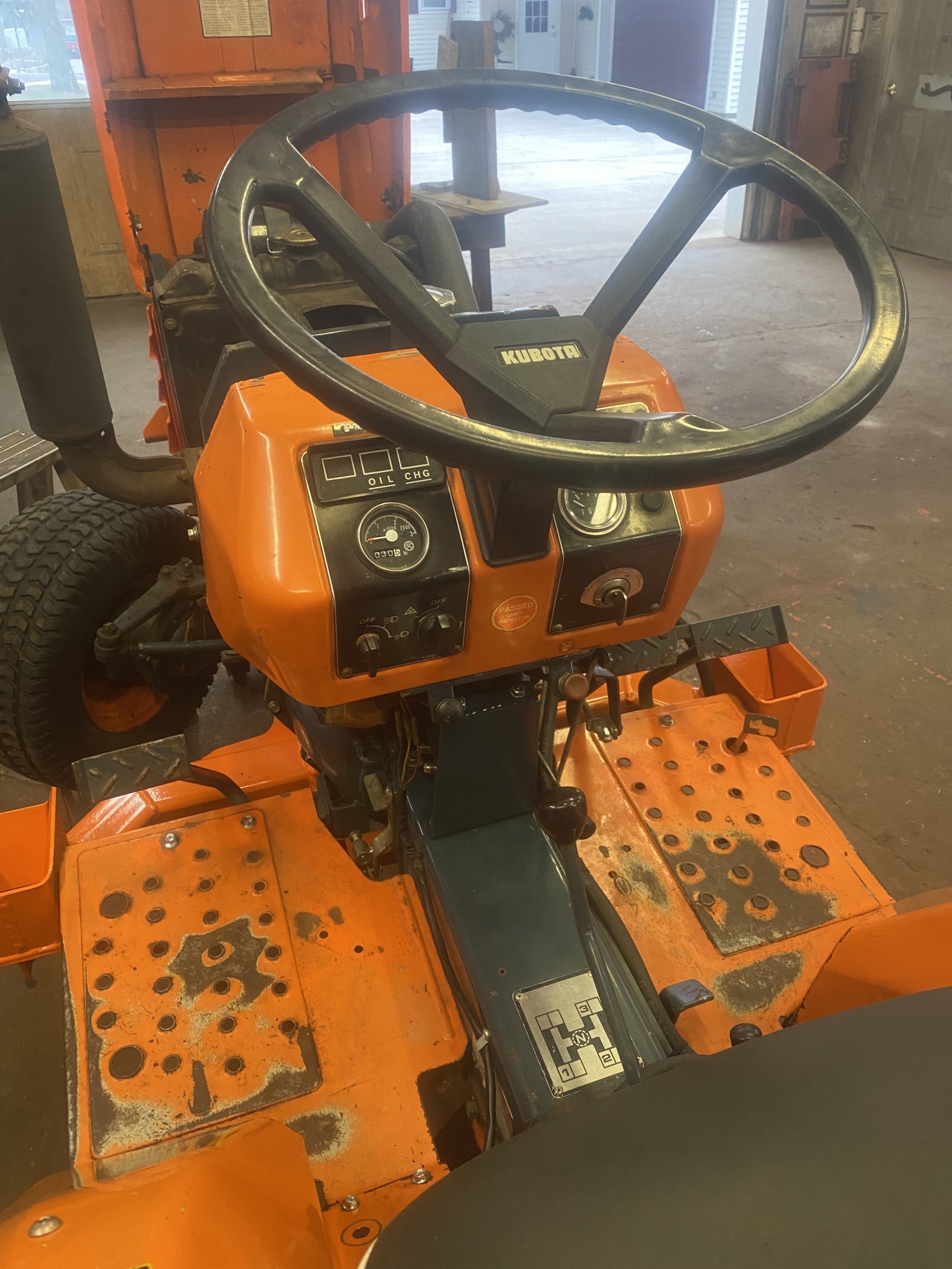

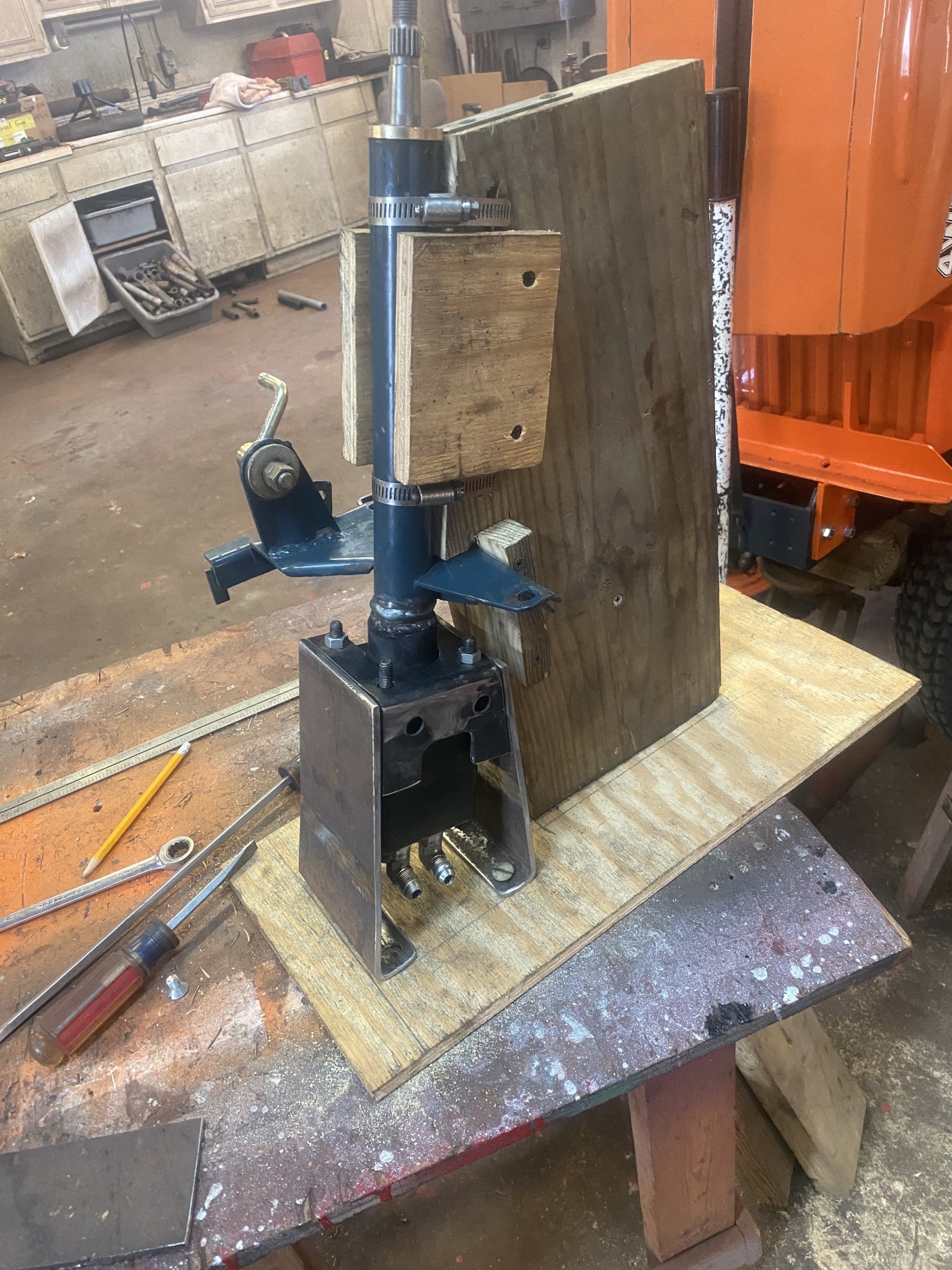

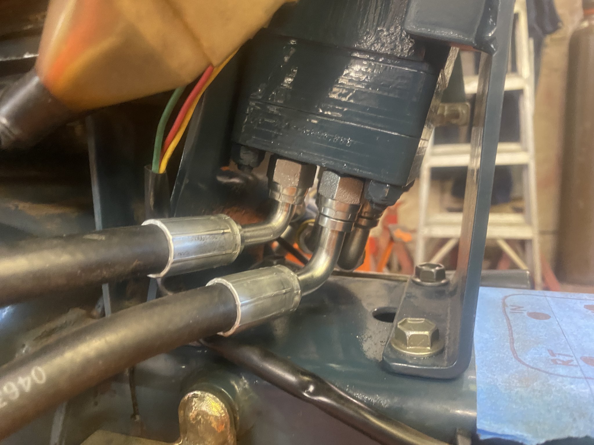

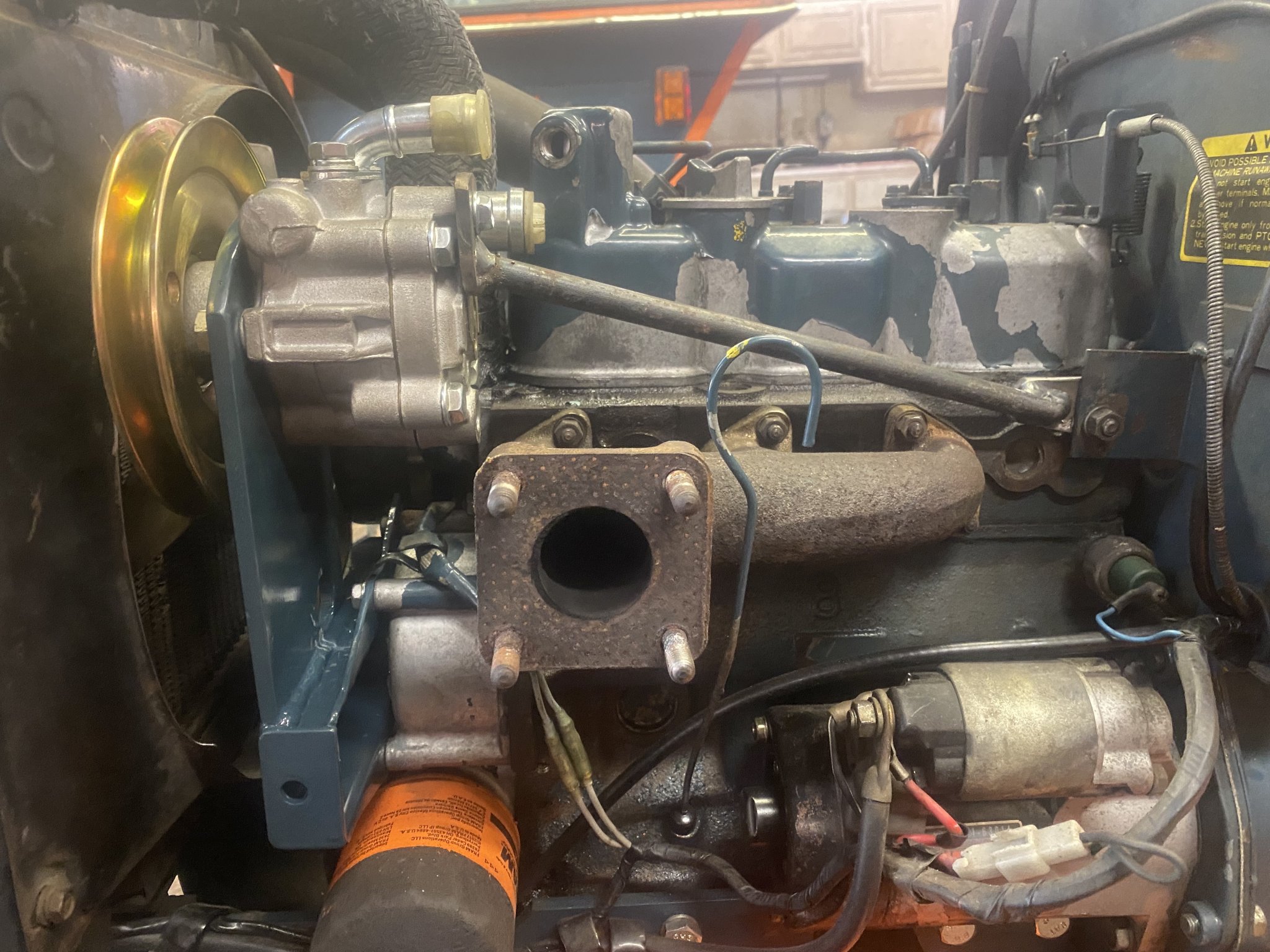

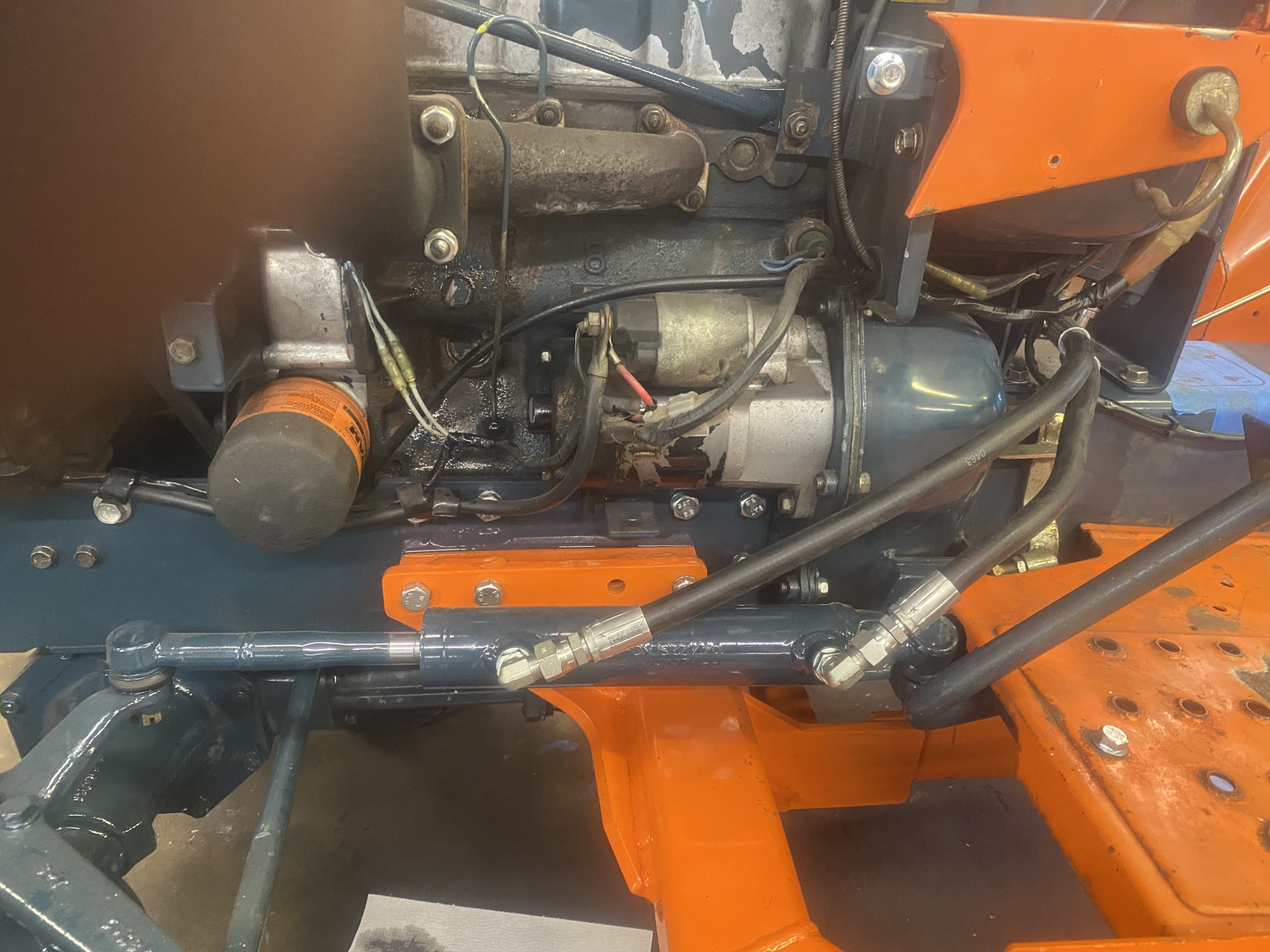

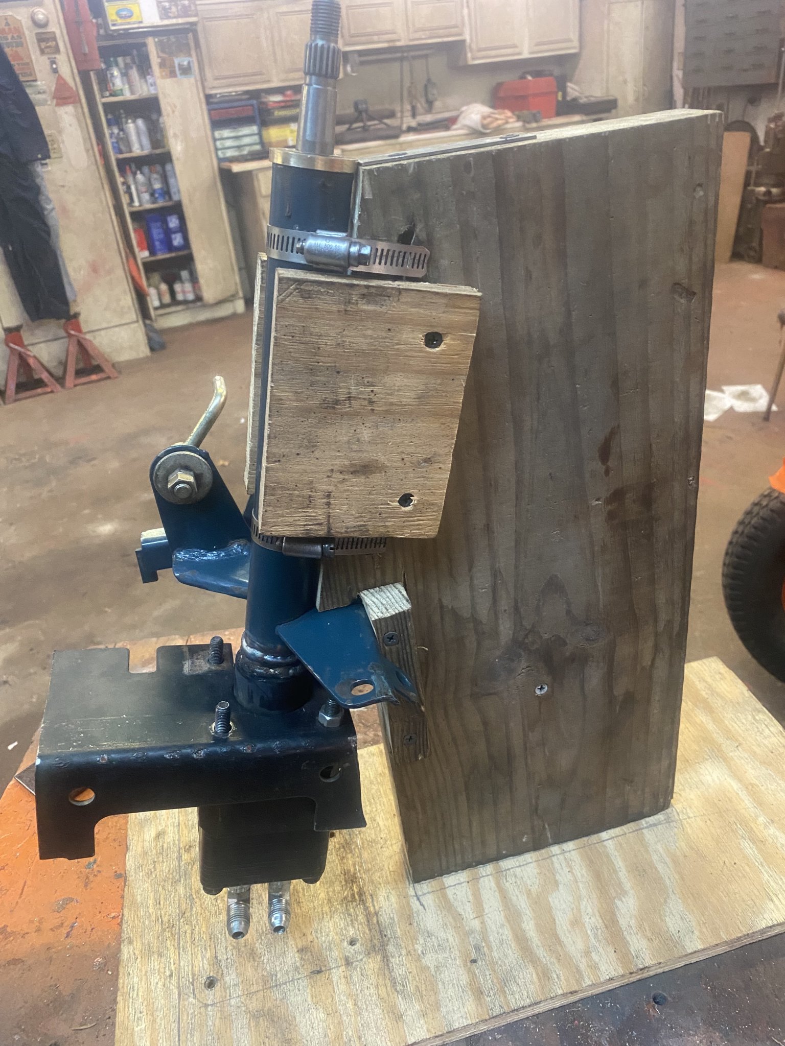

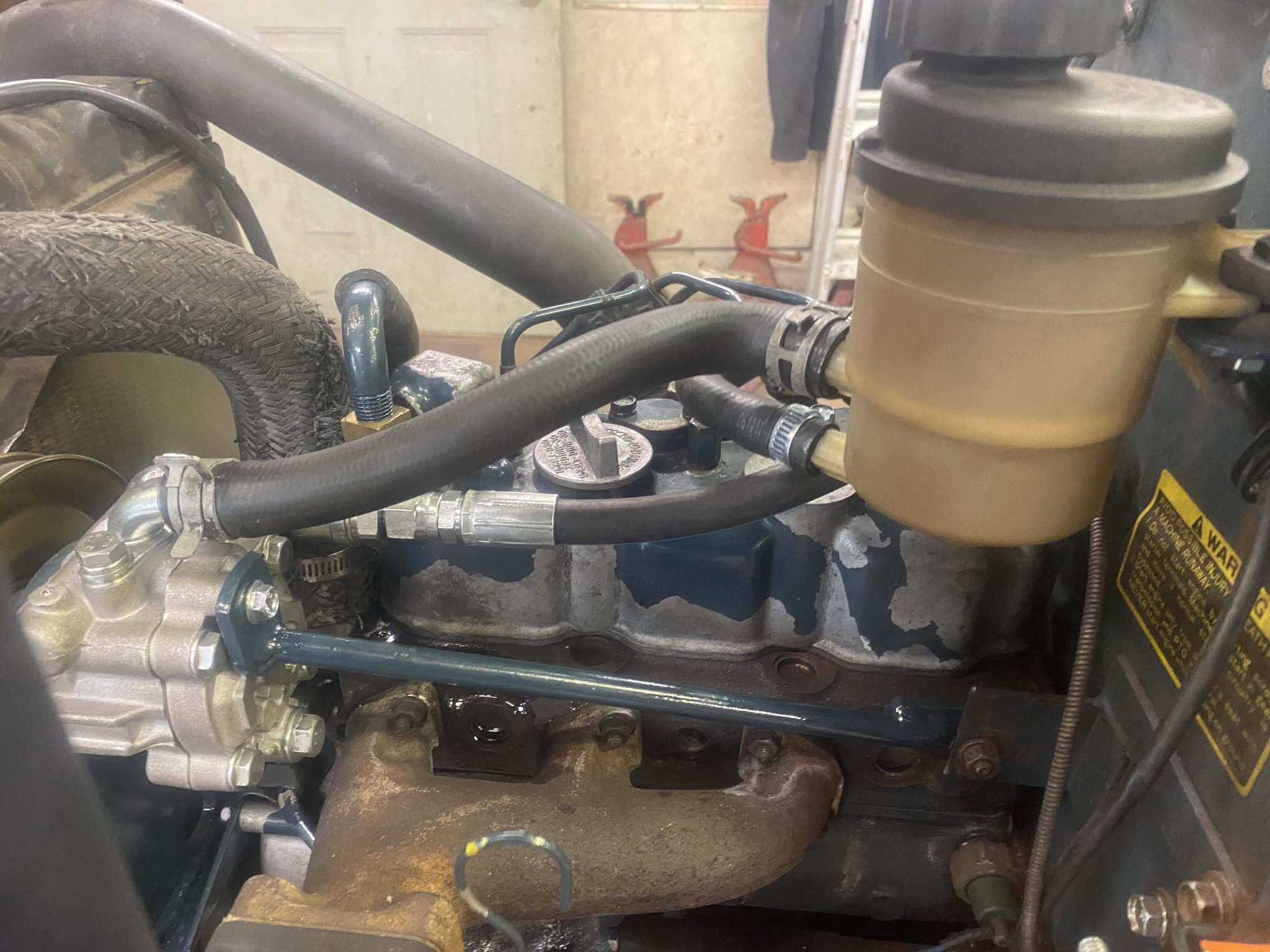

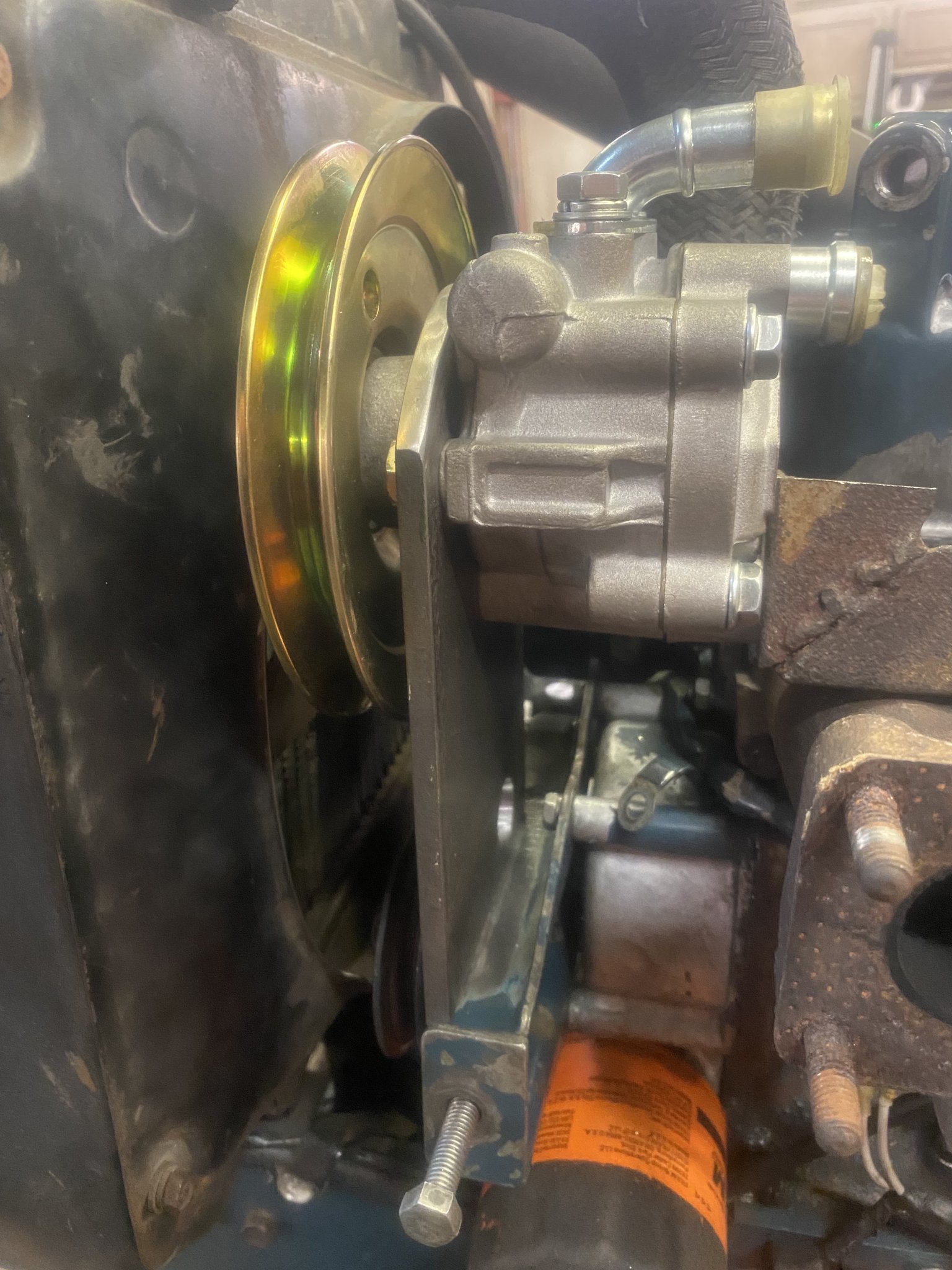

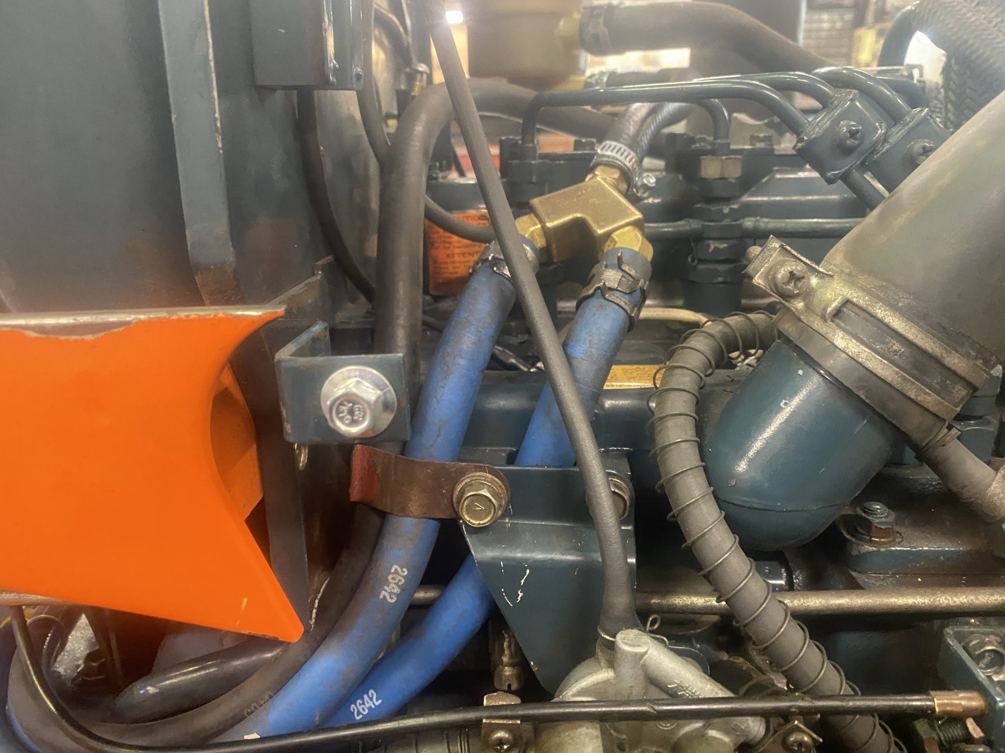

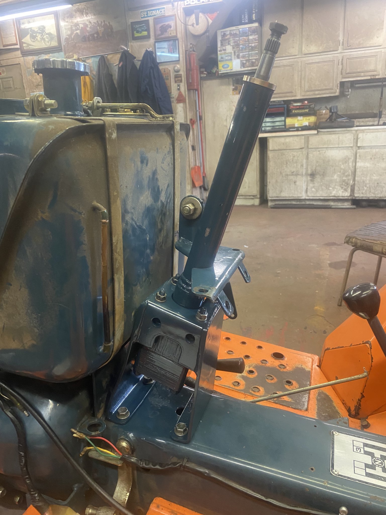

Steering with a bucket full was difficult. This is my modification. Power steering pump from a Nissan pickup. Reservoir from a Kia. Slave cylinder from Tractor Supply. Hydrostatic steering valve from a John Deere 318 garden tractor. Hoses custom made at a local shop. About $450 spent. Combining the JD steering valve with the original steering column, so that the dash would still be supported and in the correct location was the most difficult. I fabricated a holder out of wood to hold it correctly. It now steers effortlessly. Currently my photos are in the wrong format so I cant post them. I will update the post with pics as soon as I get them converted. (I hope)

I'll give you an A+ on mounting the controller and new column. (y)

It’s amazing how little effort is required to turn the steering wheel even with a full bucket.

I really like how you mocked up the sheet metal for the column mount. I am absolutely going to copy that when I do the power steering mod for my B7100.
