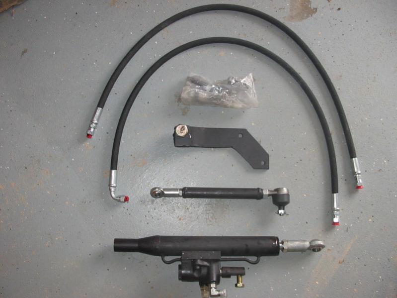

The kit arrived well packaged, which is nice, because the goonies at UPS aren’t too kind when it comes to the heavy stuff. Here is what you get.

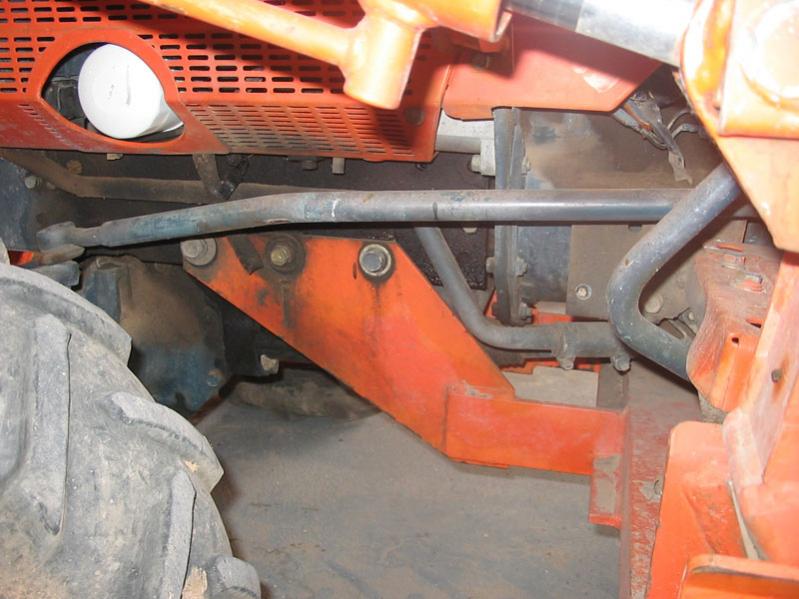

Getting the foot rest off was no big deal. No excess rust, and no stripped out bolts or broken off bolt heads! Score one for me. I think things are moving along nicely until I get to that stinking drag link! Man I hate those evil tie rod ends!
The one connecting the drag link to the front pitman arm (that’s what you call it on a car) wasn’t so bad, but when I tried getting it off the steering box linkage…lots of angry words.
I finally went and bought a pickle fork and had at it! It makes fairly quick work of those parts, but ruins the grease boots in exchange for making your life easier. If you are going to do this to your tractor, go buy a pickle fork before you begin!

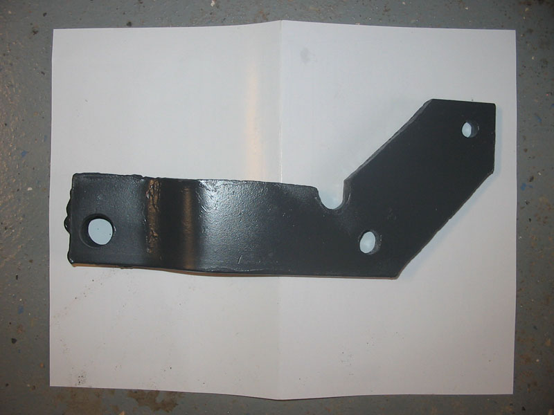

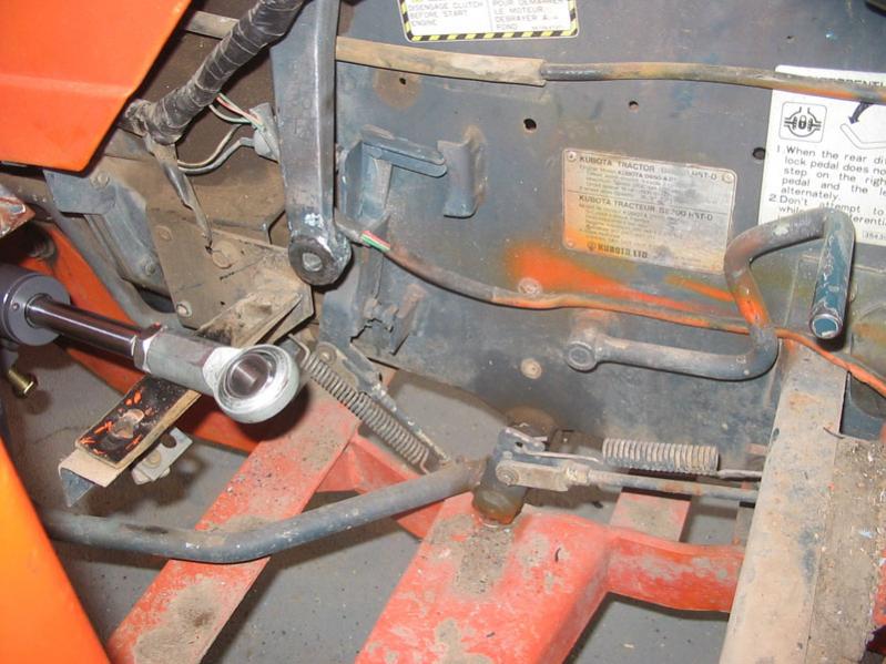

Next up, install the new steering system. This is going well until I put on the supplied mounting bracket. The holes are just a little off, so out comes the dremel tool. Got that little problem solved, no biggie. Next problem, the original bolts are not long enough to hold the mounting bracket on the tractor…off to Lowe’s. There is also a discrepancy in that there is no flat surface as there is a thicker piece of metal towards the back hole. Solved that problem by stacking 3 fender washers to equalize the height, so the bracket will sit flush with the tractor. Finally get to the point to mounting the bracket, when I notice the foot rest front mount will not go back on with this bracket in place...grrr. Out comes the grinder.
As you can see this removes a decent portion of the mounting bracket. I’m a little worried that this will weaken the bracket, but I’m going with it anyways.
