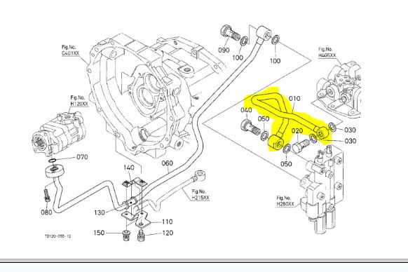

After getting the bad news I went to my Kubota dealer to speak to a mechanic. He did not seem to be familiar with this model but did show me a plate on top of the transaxle under the seat that on some models can be removed and replaced with a device that gives a power beyond access. I pulled my tractor seat off on my L3240HST and saw a similar plate. It is the plate with two bolts holding it down in photo. Does any one know about the function of the plate and what hydraulics it contains? Could one DIY the converter part?

Yes you could replace that block with a revised block to tap into, but with 5 ports in the block, I think that the block will cost you plenty.

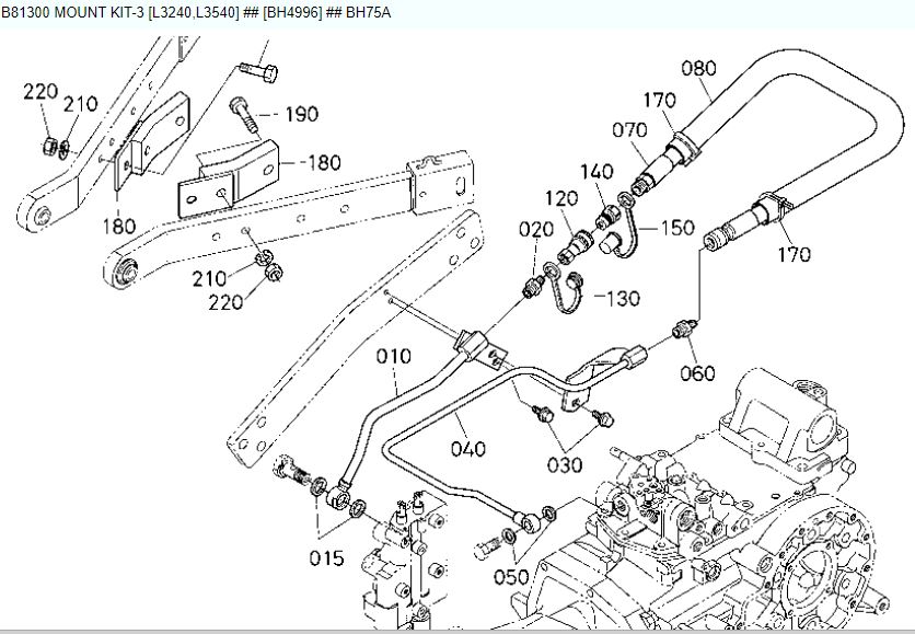

I thought about your problem from a different angle, they did install BH's on them so that's what I looked at.
Here is how they tap it, they replace the pipe in yellow, you could either try and source that setup or rather simply make you own.
This will give you a power beyond loop to run a 3rd function valve. ;)

I don't know if adding a third function valve is different for an L3240 HST than it is for an L3240 GST but I added a WR Long third function valve to my tractor a few months ago. The seat has to be taken off. There was a short piece of piping under the seat that connected to the hydraulic valve underneath the tractor. I had to take the piping loose and saw it into two pieces to get it out. The power beyond port is on the hydraulic valve at the other end of the pipe that is under the seat. I believe that is the same one that Wolfman shows in his picture. The instructions that came with the WR Long valve were correct and it contained all of the necessary fittings for installation. Hope this helps. By the way my loader is an LA 514.

FYI...
When referencing or ordering parts on a Grand L 40 series make certain to specify if it is a Dash-3 as in L3240-3 model or not.
I had to replace a part very similar to what NIW called out on my tractor (leaking weld joint) and there are two different tubes depending on the model revision (-1 or -3).
