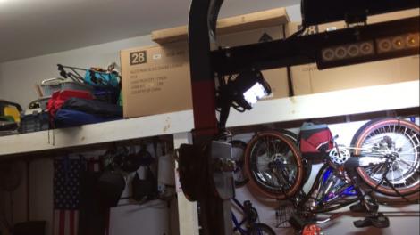

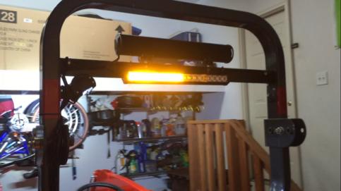

Got my LED light bar, rear LED work light and rear facing Hazard LED lights installed last night. I installed 2 rocker switches just below my regular light switch on my dash. Install went great. That LED light bar really does turn night into day. Love it. I attached some pictures I took from my video. I have also included the you tube video link below so you can see them live. Enjoy.
Here is the video link.
https://www.youtube.com/watch?v=-KMCFszjo7Q

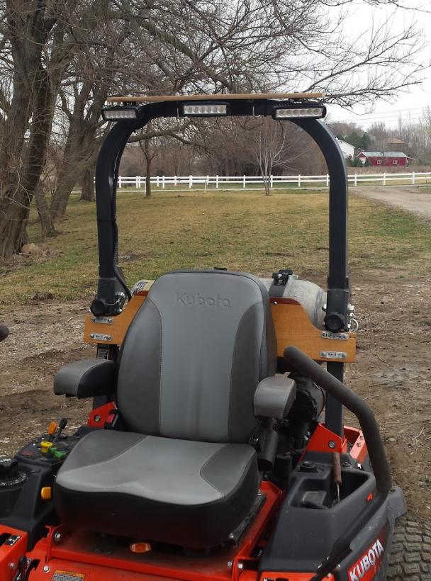

I never did much metal work before all of this or never welded either....
How are your woodworking skills? My welding skills are above average and I have a MIG, but I just rebuilt my light rack out of wood. I used white oak and it attaches to the roll bar with 2 square U-bolts. The tractor lives indoors when not in use so weathering isn't going to be a problem. I have 3 18-watt lights facing the front with the 2 outside lights rotated out about 30 degrees. This produces about 210 degrees of light around the tractor with the illuminated area getting all the light I could ever possibly need. I might add 1 facing the back, but I haven't felt the need yet.

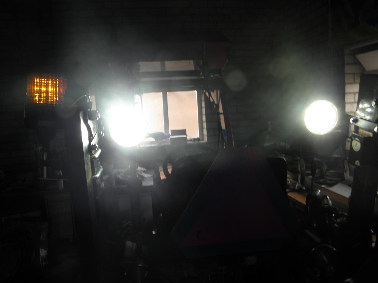

The one I designed is attached to the ROPS without any drilling. It's an enclosed unit with a LED light bar pointing forward and a led tactical programable strobe light pointing back. It's low profile and it's worked well for the last two years it's been on the machine.
Forward :
Rear

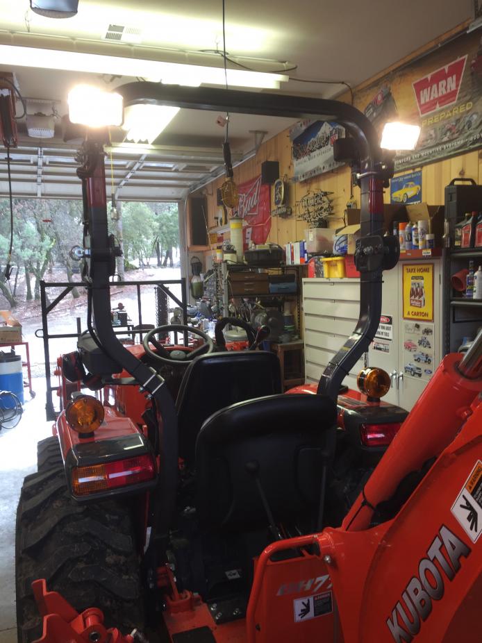

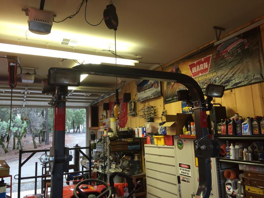

I already have many Grote 55 watt halogen tractor work lights so I used what I had in stock. In addition two Bosch Relays, fuse holder, 3 way toggle switch, wire, loom, a couple of square bolts, and some aluminum were used. LED lights would have been nice and most likely would need no relays, but like I said I have the halogens. I wired so that the ignition switch has to be on for the lights to work, no dead battery that way.
Works great, plenty of light forward and behind.

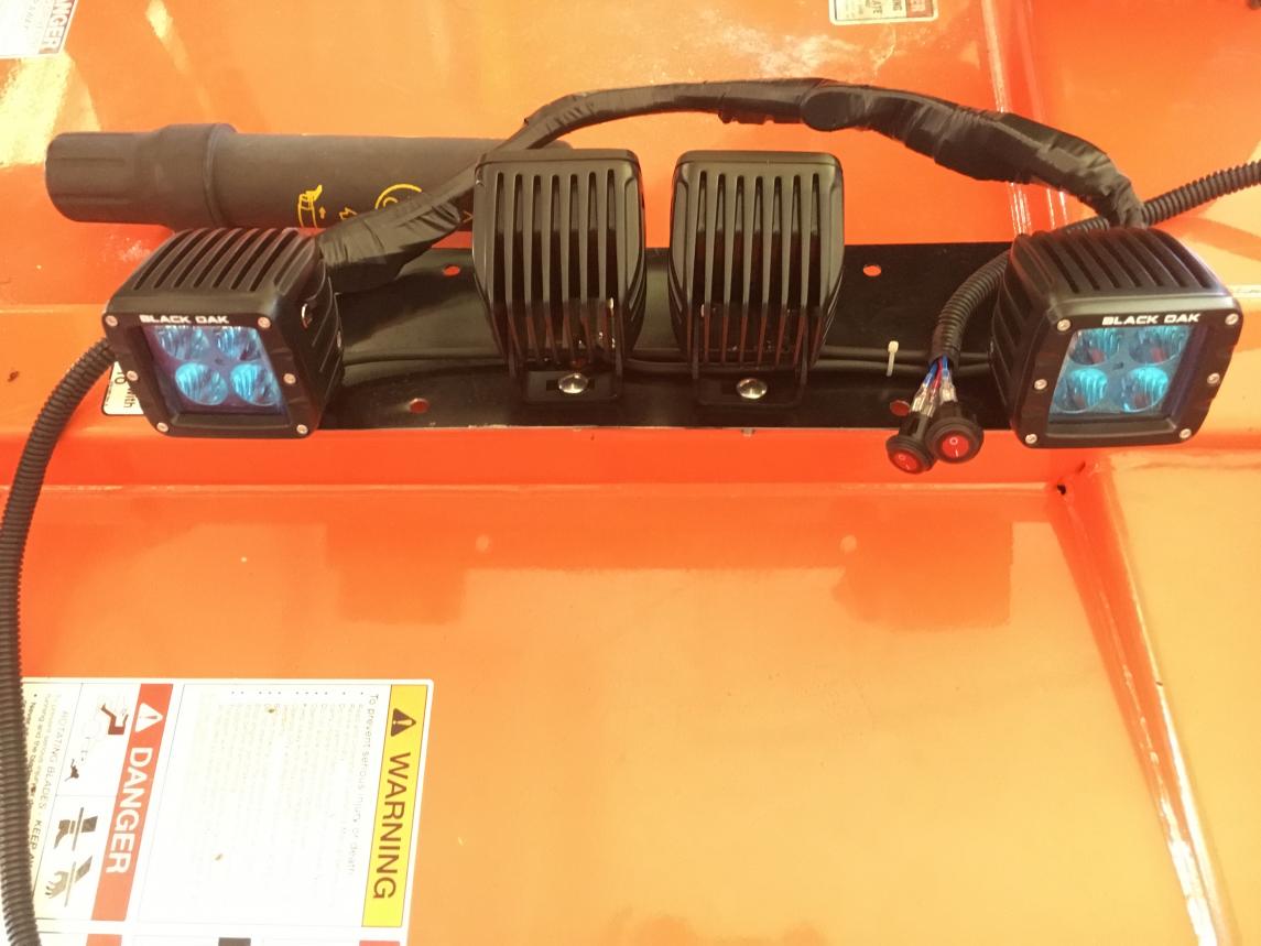

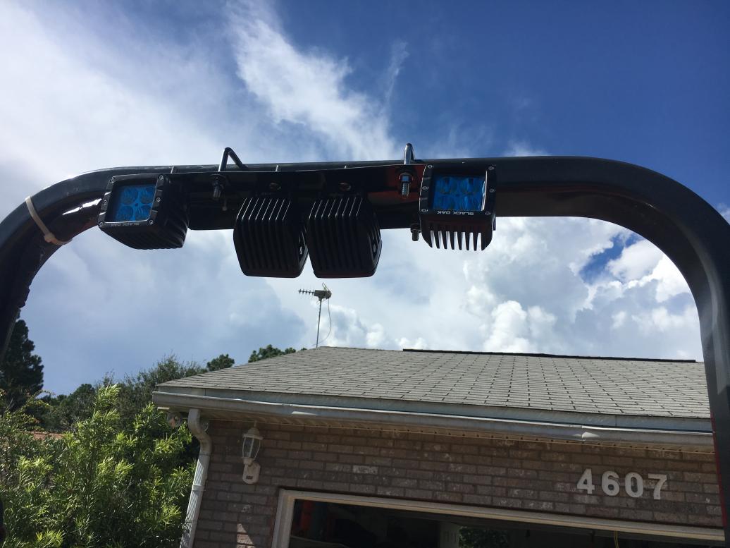

I have a L3901 that I purchased recently - love it. Living in Florida, it gets dark by the time I get off of work. I asked the dealer to install some work lights - the first pictures is the light that the dealer installed. I wanted a little more lighting so after researching my options, I installed 4 - Black Oak, 2" turret style pods. I followed the factory installed light wires and zip tied the wires along the frame to make it look like a factory installed option. Each light produces 3120 raw lumens and draws only 2.8 amps each. I'm very happy with the amount of light, the wiring harness with switch was a complete surprise. I'm much happier with front and back lights then the single light instilled by the dealer. I can see very well - turns pitch black into daylight.
