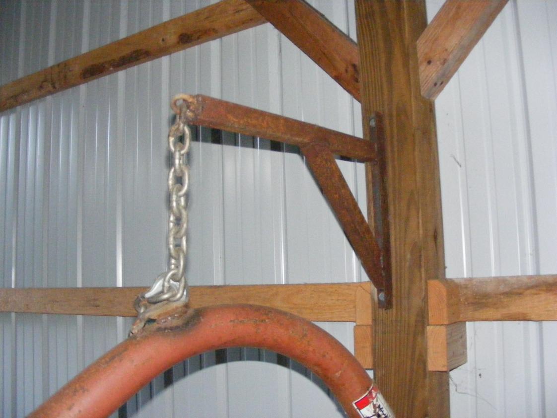

How do you get it over the top beam? Is the beam removable then slides back in the slots? Thanks for the pictures.
Yes, the top beam just slides out. Hitch up, raise the hitch, pull the top beam out, drive away.
Just the opposite to remove.
This system works very well, there is no fighting the implement to get it attached and ready for use. ;)

Mntview, thanks for the pictures. It rains a lot in Ga, so an outside stand was not an option. I did take part of your idea with the cross bar. I took a
4x4 post 32 inches long, cut a slight depression in the center, put a hook on each end and hung it from one of the beams of my metal barn. Works just like you said, unhook on of the ends, let the post hang down, back the hoe into position, hook the post (cross beam) back up, let the digger back down to rest on the post and unhook and drive away. Turned an octupus into a pussy cat...

:cool: Simple and clean. There have been several people that took this idea and put it on a rolling cart and keep everything inside. If I kept everything inside, I would need a 10,000 foot shop, at least. :eek: Simply can't afford it. :(
