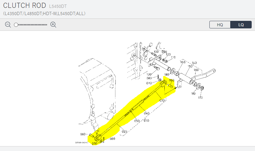

I think we need to clarify a few details, It's not very likely that it has a wet clutch or what Kubota called an EC, as I don't see it as an option on that model.
But it wouldn't be the first time that Kubota has slipped in an odd one.
If you can give me the serial number I can give you exact details on how to adjust what I suspect is a dual clutch disk.

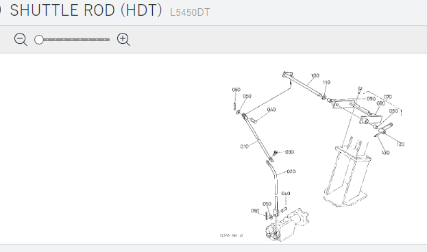

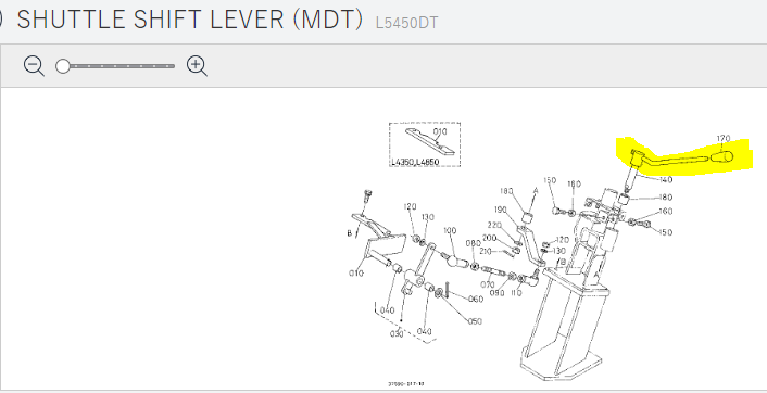

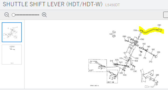

Ok serial number didn't help nail it down.
There are three variants of the L5450DT
MDT
HDT
HDT-W
Does you shuttle lever look like this?
Or does it look like this?
If it looks like the second, next you'll need to look at the shuttle linkage.
Is it like this?
Or like this?

Ok, the shuttle shift lever is the second diagram, the lever has a bend at both ends. And the shuttle rod / linkage definitely looks like the last diagram with it being on left side of the steering wheel going down and is two pieces with the connection point visible just below the sheet metal that the fuse box mounts to. Thank you again

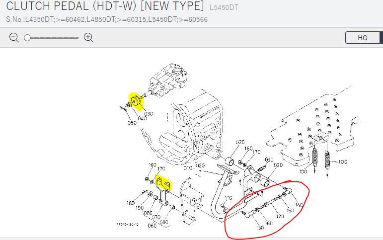

Ok see you were right!
It's a L5450HDT-W
L5450 Hydraulic shuttle, Dual Traction (4wd) Wet (dual hydraulic clutch)
What looked to be a Mechanical clutch was actually damper disk installed where the travel clutch should be, Dang Kubota slipped one past me again!
Ok now on to how to check / fix/ adjust it!
Check for excessive wear on these parts in yellow, if there is then you'll need to do some replacement parts or repair those parts.
Also check for dirt / debris that would imped its movements.
If all of that looks good, lengthen the rod in red just a little bit and see how is does.

The travel clutch portion would be adjusted as I said and shown earlier.
The PTO clutch adjustments are done to this linkage.
