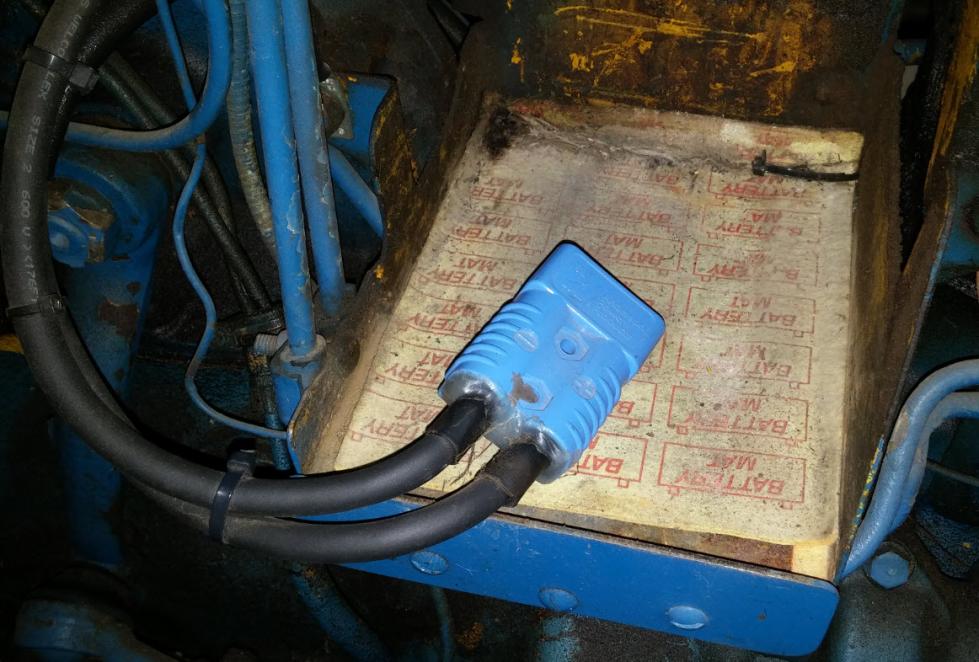

While I like my JNCAir combination battery jumper/air compressor https://www.amazon.com/Jump-N-Carry-JNCAIR-1700-Amp-12-Volt-Compressor/dp/B000KPU8F2 that I put in the car for long trips, below is another option that may work well for you..
After getting tired of having to keep chargers on my old tractors to keep the batteries in good condition, I decided to convert them over to one removable battery that can be used in either tractor. I use a battery large enough to easily start the tractor but small enough to be easy to carry.
When the battery is not in use in a tractor, it is stored in a heated basement on a battery maintainer.
The tractor and the battery has large Andersen connectors suitable to carry starter current and make it quick and easy to connect and disconnect the battery.
So rather than carry a jumper battery, use a battery with connectors, that is kept stored in a warm area and kept in good condition with a battery maintainer.

Invest in some Andersen plugs.
Connect one permanently to the new battery in your tractor.
Cut the end off a set of booster cables and connect an Anderson plug to them.
Now this will sound silly to start with but with an Anderson plug both ends are identical, but the design allows them to lock together to produce a very good contact between two cables.
The main advantage is they will take a large amperage. They can take 50 amps or 100 amps or more depending on the model.
Advantage when buying you don't have to look for the male and female version they are the same.
Now your new tractor battery can easily boost your car, motorcycle, your garden tractor.
You could even use it in reverse to boost your tractor in 5 or 6 years when its battery starts to go again.
Amazon.ca sells a wide variety. This link is for a #4 gauge wire, i.e. heavy duty for starting service.
https://www.amazon.ca/Install-Bay-S...484464398&sr=8-5&keywords=anderson+connectors
The blue connectors in Dandeman's post are Anderson connectors.
