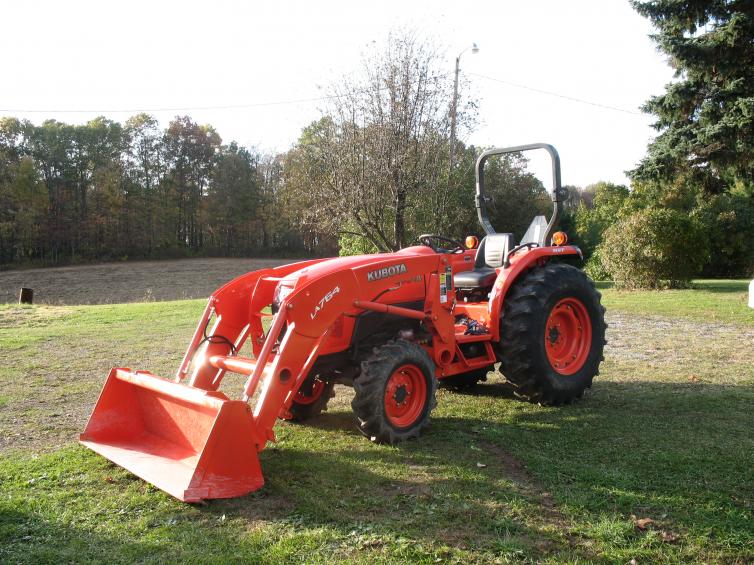

Hey Z man ( I have to assume you got that name cause you got/had/ or collect the Z series , or ya got a Z 28) anyway, hows the new tractor? Did you get any pics yet common man lets see it,, ;)
