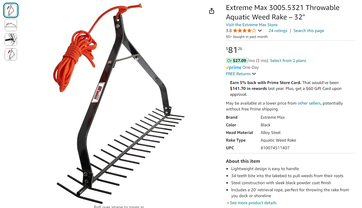

From what I was reading bottom up aeration proves to be helpful, so i am starting there and using a pond rake 16"-24" with a rope and have the tractor pull it out. it will take awhile but figure I'd work on it slow to see what works and what doesn't. Like you my pond is heavily stocked with fish, frogs, turtles and I'm on conservation land so draining is impossible..

I was thinking maybe something like this with a longer rope that I could pull across the pond. Another option vs a long arm tool on the FEL or 3pt

there's another post about using a landscape rack looked like a good idea !
maybe remove 1/2 the tines to do a 'coarse' raking ?
Whatever you use best tie GOOD knots in a NEW rope !

Your imagination might be running wild. You say your soil is hard clay then say bottom is gravel along shore and covered with 12" muck farther out. You say there's not much vegetation but you think a rake will make a difference. You can drag that rake through pond all day and still not pull enough mud onto bank to fill a 55 gallon barrel. To increase depth of a one acre pond by 1 foot requires 5,863 fifty five gallon barrels of mud. What you will accomplish by dragging a rake through pond is suffocate the fish with stirred up silt.
Buy a 3 point dirt scoop and dig an additional pond. That'll keep you busy and yield 100x more water storage than same # hours dragging rakes plus you'll wind up with 2 ponds and not kill fish off.
