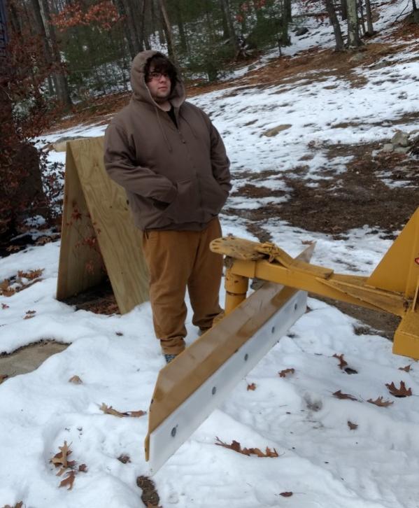

I have a front mounted blower. Last winter I need the loader and forks in to December. Bought a piece of UHMW and replaced the cutting edge on my back blade. Worked well. From usplastic.com that piece (1/2"x6"x5') was $77 w/shipping.
Blade Edge.jpg .
Bucket with stock edge will leave scratches. Those scratches will fade away in the spring.
