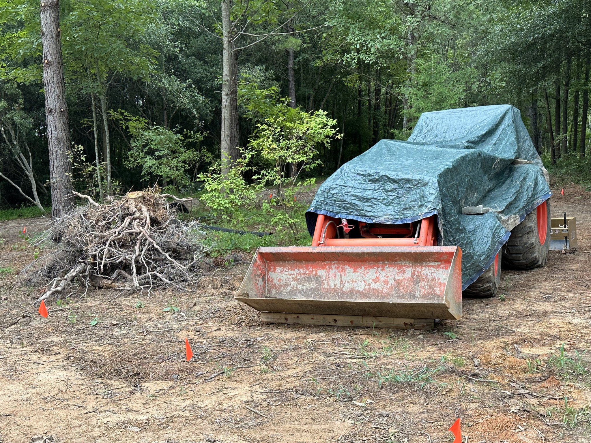

At this point anything is an upgrade from my “tarp barn”.

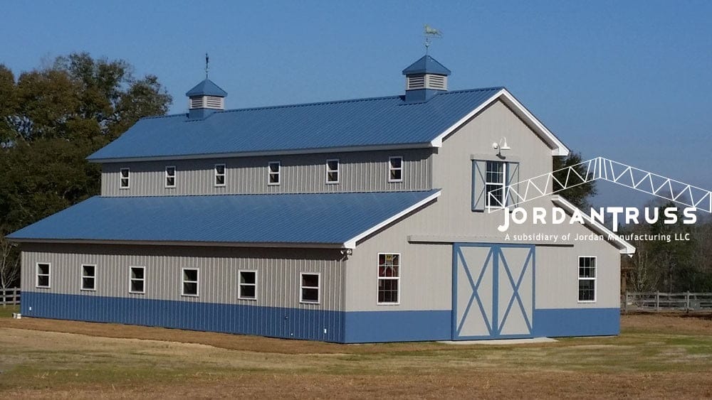

here is an example of steel truss supplier
