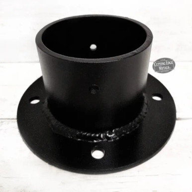

How would you attach the poles to the concrete? Simpson has a PBV (Post Base for Vigas) that look acceptable for this type of structure since the tops of the poles will all be attached together by the top rails and also the girts.

If you want a pole built design then I would go concreate in sonotubes with CB66 or CB88 post bases
or Midwest Perma Colum swp bases
