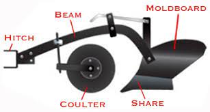

ive got a single bottom plow that normally just sits in a pile until I need it, then it’s like wrestling a greased pig to get it up at Dogwood attached to the lift pins. Anyone have any good ideas on how to store it so I can just back up to it to attach?

What kind of plow? Moldboard plow or potato plow or some other type?

First off set it on a pad like a couple 2x2 flag stones and use a cement block up hold the front end up out of the dirt it should stand up right like that and cover it with a tarp. #2 Spray round up or something around where you store it and kill off all the weeds and biteie things. Clean it when you are done oil up the moldboard or spray with at least WD 40, paint the frame work a rattle can works. Granted it is just a hunk of iron and steel but take care of it you paid good money for it
