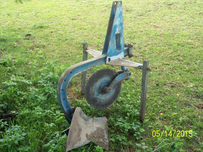

If you're going to break ground for the first time, you need something like this. That round disc is called a coulter. The coulter cuts the grass ahead of the plough share, making plowing fun not work!
You can adjust it up or down to slice the vegetation. It's also extremely important to have/keep the plough share clean, shiny clean. You can use a wire brush. Plow some sand. The best, quickest to clean the plough share is to pull it through an abandoned RR bed. (sometimes hard to find!!)
I made this years ago from a John Deere 2 bottom plow being hauled to the recycler. Didn't take much work or time and it's about 1000 time better then anything bought at Tractor Supply or similar implement dealer today.
