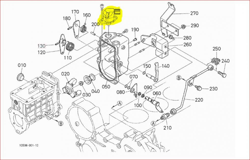

28,698
5,118
Here is a picture of the stop solenoid, that would be the first thing to check.
It's located on the top of the governor housing.
