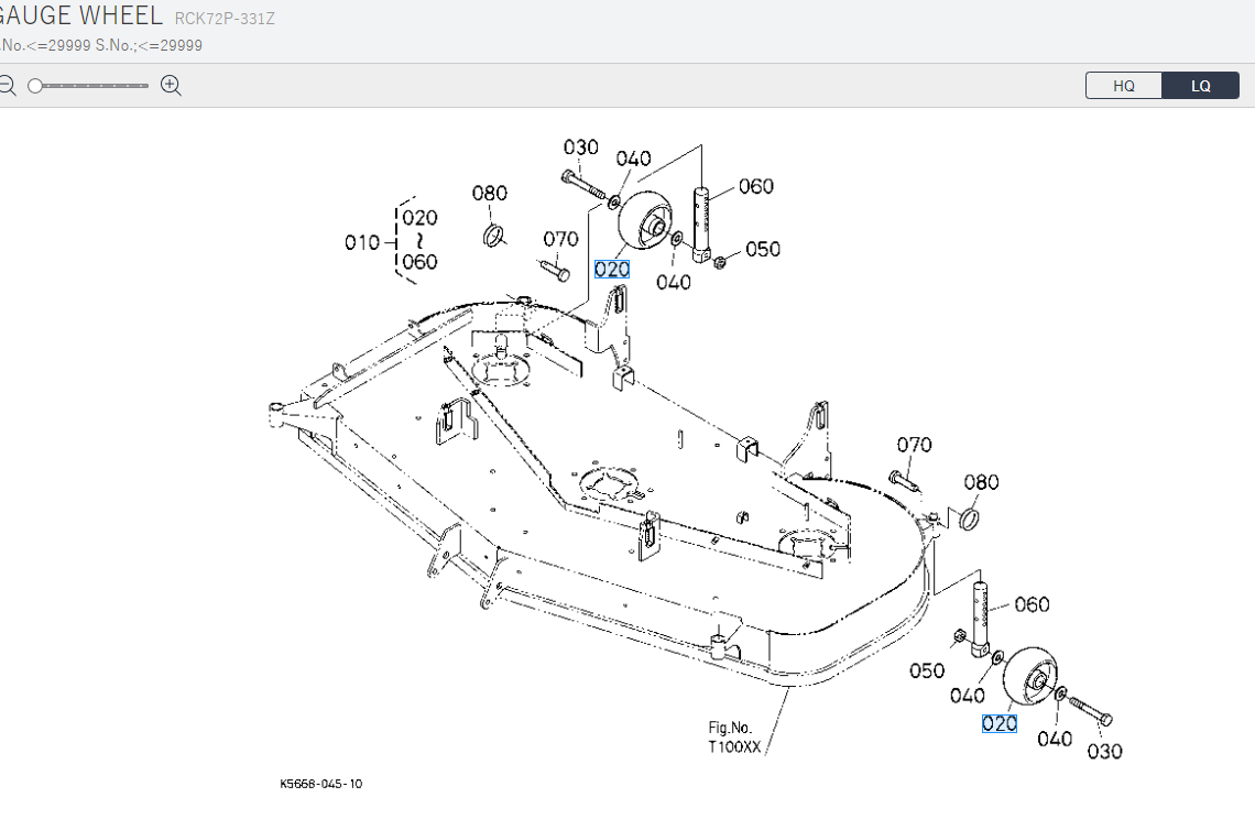

Only the wheels or everything they mount with?
There is a serial break for the deck. Below are the numbers for the one pictured.
28,955
5,301
You're pointing to two different wheel sets.
The fronts and middle rear are Anti-scalp rollers, the other outside rear are gauge wheels.
What do you need?

Gentlemen, thank you so much for helping me with the part numbers!
Part #100 on the diagram the fork (shaft holder) for the front and 060 gauge wheel shafts
Matt, that link is gold. Thank you for the lead!
Part illustration #060
K5645-72680 PIN,GAUGE WHEEL
Part illustration #100
K5668-43113 SHAFT(HOLDER)
