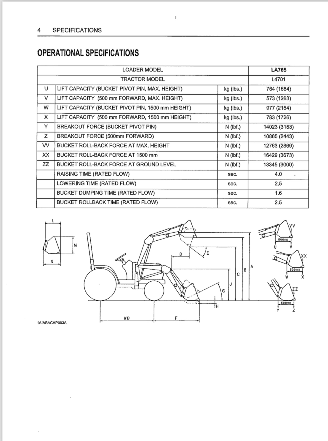

Having put a few hundred hours on a L4701 and test driven a MX5400 for a bit at my local dealer due to boredom whilst they were finishing up rear remote install on my L which I thought was ready for pickup due to a miscommunication, the MX5400 felt like a slightly larger, but otherwise identical, twin to my L. I don’t think you’d be disappointed with either.
So far as loader capacity, here’s some more detail on the LA765 that may give you a better feel for what it really will and won’t do. Full height at the pin rating may be OK for comparison but it would be pretty rare to hook a load at the pin and raise it to full height so some more info might help. I would think the dealer should be able to provide similar specs on the MX loader if you can’t find the OM for the loader online.
