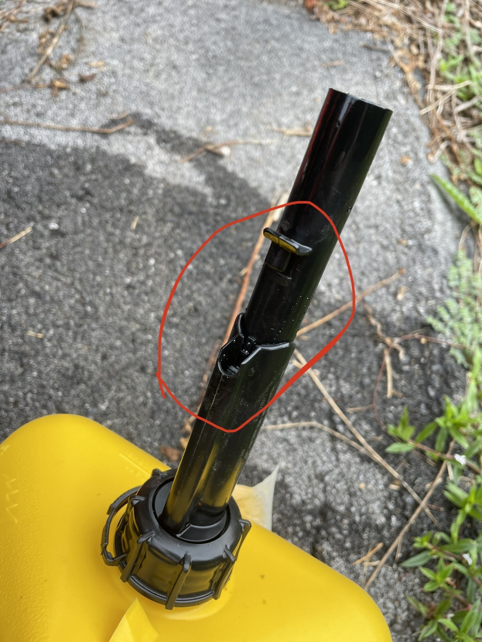

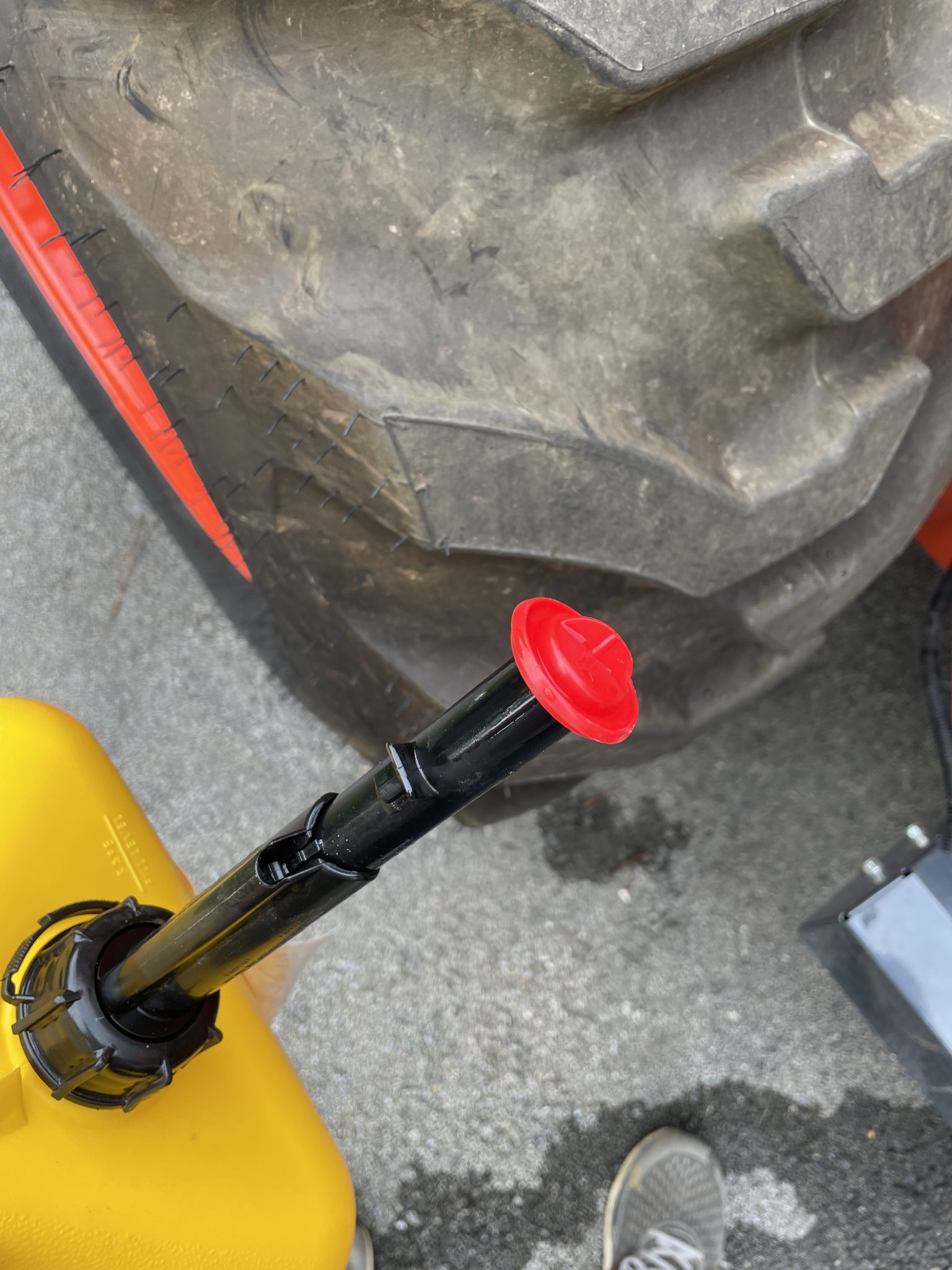

So I think I just made a very timing consuming to fix oops. While refueling my tractor with a 5 gallon can, a plastic piece snapped off, had something to do with the air intake breather on the new type plastic cans, anyways it fell off and as my luck would have it, it fell into the tank. I have an idea, I checked the stopper cap for the end of the spout, it’s made of the same material, it floats in water. So my idea is to park the tractor on an incline, then fill the tank all the way up and hoping that the plastic piece will float up to the top where I can reach it. Otherwise I guess I’ll be taking my tank off this week. Anybody else have any suggestions?

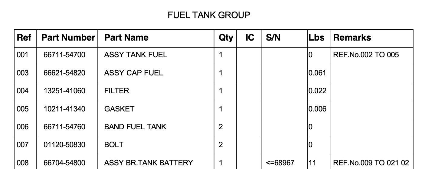

Would be nice if Kubota would put removable screens in the tanks to keep things out of the fuel tank. The John Deere skidder I ran for 2 1/2 years had one.
They used to.
My B7100 still has the original.

So I think I just made a very timing consuming to fix oops. While refueling my tractor with a 5 gallon can, a plastic piece snapped off, had something to do with the air intake breather on the new type plastic cans, anyways it fell off and as my luck would have it, it fell into the tank. I have an idea, I checked the stopper cap for the end of the spout, it’s made of the same material, it floats in water. So my idea is to park the tractor on an incline, then fill the tank all the way up and hoping that the plastic piece will float up to the top where I can reach it. Otherwise I guess I’ll be taking my tank off this week. Anybody else have any suggestions? View attachment 105872 View attachment 105873
