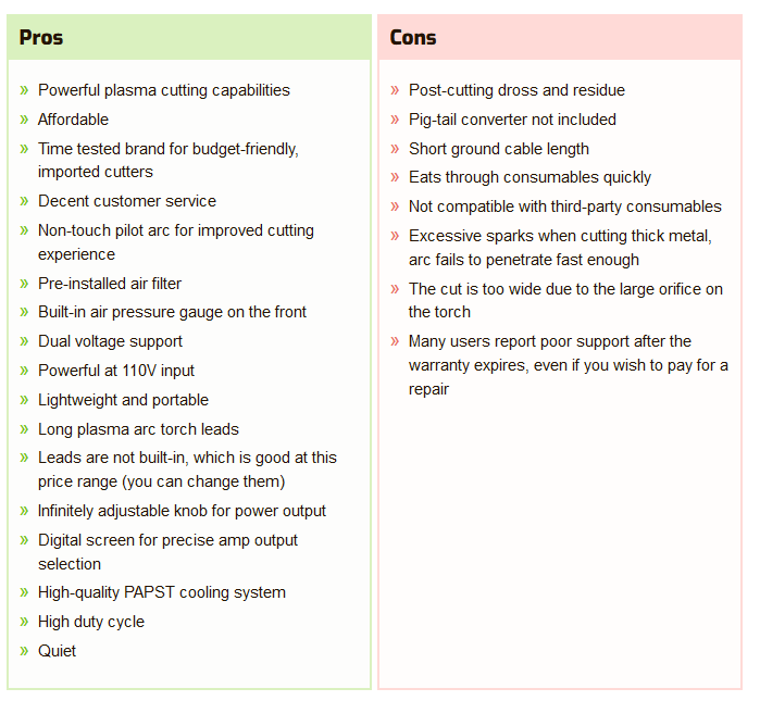

Well, I did some research and found out the Hobart 12ci was only rated at 12 amps. I probably overloaded it cutting that PTO shaft. I looked at reviews on the Titanium from Harbor Freight and while the pros were good, the cons were a turn off for that price point. An alternate unit the reviewer pointed out was a Yeswelder CUT65DS. It is a 65 amp cutter with up to 100% duty cycle for thin metals up to 1/8" and 60% for 3/4".
