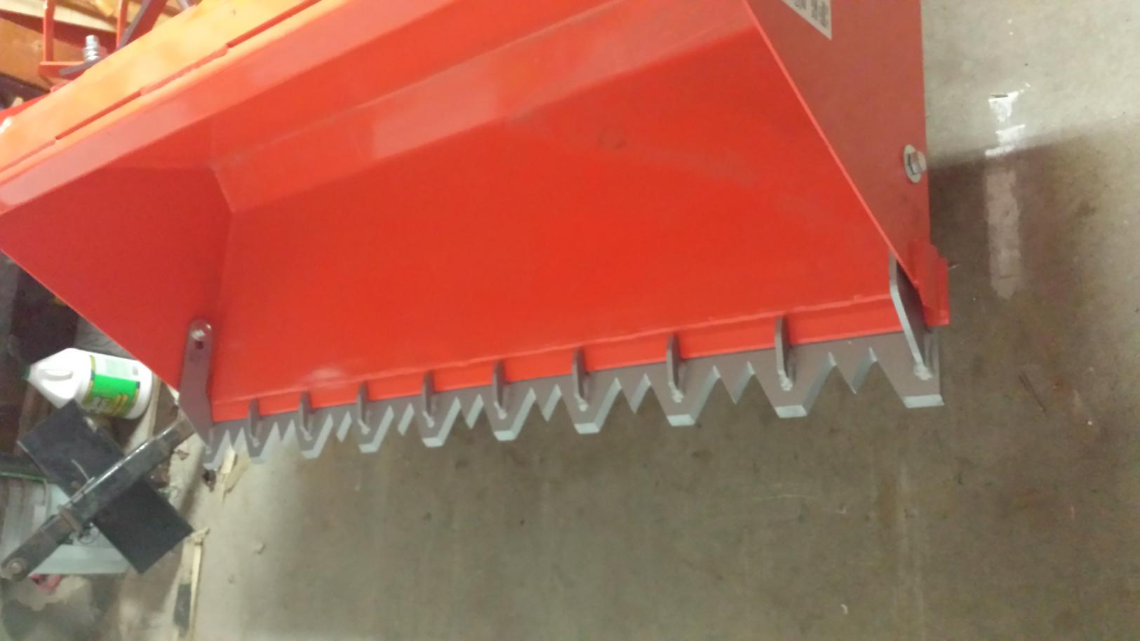

I AM HERE TO PROCLAIM THAT I AM A COMPLETE IDIOT. BUT I'M NOT GOING TO TAKE BACK EVERYTHING I SAID ABOUT BXPANDED SERVICE.
It turns out I was wrong, so I'm fessin' up. However, I'm going to share the blame. I was told that the bar would be shorter than the inside of the bucket by their phone people and that our 46 1/2" bucket took at 46" bar. WRONG! Apparently, after talking to the production manager, Howard learned that the bar doesn't fit inside the bucket, just the mounting brackets (I suppose I could have figured that out by looking at the pictures, but, hey, I"m just a customer). So, the 47" bar fits the 46 1/2" bucket with the bar outside the bucket and the brackets inside. And here, Howard said it was to be 46-46 1/4" to fit inside.
Long story short, I take back everything I said about the bars being the wrong size and apologize to Bxpanded for my rants on that subject, of which there were few. The issue was and remains delivery and service. But, that sounds like I'm minimizing my stupidity, which is not my intent. I look forward to getting the bar on and seeing if it's as slick as advertised. If so, I will heap high praise on Bxpanded for that aspect.
I suggest no one on OTT listen to nothing I say going forward, though. Egg on face. In fact, let's pretend I don't exist for a while. I'm really starting to question my sanity, or at least my ability to do simple nut and bolt operations and figure out how something that doesn't even move is supposed to work. DUH! If I'd taken acid in college, I'd blame a flashback, but I didn't, so... tell me I'm not becoming stupid in my old age.
Now, I want the scream emoji so I can scream at myself.

I AM HEREBY RESCINDING MY PRIOR ADMISSION OF IGNORANCE AND STUPIDITY! (Though many would argue both conditions are facts)
The mistake I made was reading the instructions! On page 4, item 4. it reads "...The sides of the Tooth Bar fit inside the existing bucket's sides." It should read something like "While the Tooth Bar itself is designed to extend past the sides of the bucket in order to protect the corners of the bucket, the mounting brackets are designed to fit inside the bucket." Fool that I am, I took the instructions at face value. When I tried to place the Tooth Bar inside the bucket, it was too long. Now, some may argue that if one were halfway mechanically inclined, they'd see the foolishness of what they were trying to do. But, I was in a hurry. It was a cloudy day. My dog hurt his foot. The Chinese were spying on me. So were the CIA and FBI (now that we know they do that sort of thing, that's kinda scary). The bread I baked did rise, but it was dry. So, leave me alone, ok!?!?
So, I got the thing on. It took me more than 10 minutes, but I'm slow. And apparently, I need new drill bits because I broke the first 3/16" after sawing away for what seemed hours. Did you know motor oil isn't as good as cutting oil and smells funny when it gets hot? Anyway, I got the thing on and while one bucket doesn't a statistically significant study make, it is an opportunity for me to say something nice about Bxpand, anecdotally anyway.
The prior owners of this 25 acres were packrats and just threw junk in a pile. Well, piles. Or just dropped it where they last used it (you'd be amazed what we've found in the timber). So there's a still fairly sizeable pile of dirt, metal, glass, wood, you name it just north of the house. I cleaned up 2/3 of it with the straight edge on the bucket, but it got to the point it couldn't dig in any longer (it might have been the rusted, busted, and bent antique auto radiator grill and a few pieces of 3/4" pipe along with Lord knows what else), so I left it for the Piranha install. Lowered the bucket and drove in- filled the bucket, slick as a whistle. If it's always this good, one will be very pleased!
Now, I think I'll rewrite their instructions for them. Theirs aren't as bad as ones written by software engineers, but anytime anyone with any kind of engineering writes anything, you know you have a challenge. lol

I think that you should just leave well enough alone. The BXPanded website plainly states that you should measure your bucket before you order and then order the bar that will fit inside you bucket to the nearest 1/4 inch. The instructions could not be more clear if you are reading American English. Here is a link to the instructions.
https://bxpanded.com/assets/images/How to Measure Bucket.pdf
Nice attempt at Humor, Armylifer. Clearly, you read all my posts and fully understand that I checked the Kubota BX box AND measured AND was thorough in my questions and additional information in the additional comments section of the order page.
In "American English", the "bar" does NOT fit inside the bucket. The mounting brackets fit inside the bucket.

Yeah, the rant about the bar being the wrong size is on you. But the fact that they just cannot keep up with demand and show LITTLE communications with the customers is unacceptable. I can understand supply and demand delays. But at least communicate with the customers that are waiting. Let them know things are backed up due to demand, lack of steel, or lack of labor, etc. When I ordered, lead time was 3-5 days. Due to all the other reviews, I fully expected it within a week. For me, the communication/customer service issues are the killer. Just frustrating.
You're right about my rant. I didn't stop and think when I tried to lay the bar inside the bucket for a test fit. I clearly didn't think at all on that one. My frustration over this thing got the better of me and my brain just up and laid down and died. No excuses.
I'll probably get their under armor at some point if they'll let me.
The good news is that I was at least reasonable when I was on the phone with them- that will make it easier to apologize.

Another small advantage I have found with the PTB- it makes spreading/sprinkling cinders/gravel a little easier. Without the PTB, you would slowly tilt the bucket down until everything came rushing out all at once. With the PTB, material tends to come out of the bucket slower & more evenly distributed. Not a huge advantage, but I'll take all I can get.
I agree with the sprinkle part too.....seems to allow for finer control of the spread.
I also find backdragging a lot more effective with the PTB....that 1/2 lip on the bottom side helps quite a bit when "flatting" out gravel...dirt or whatever.
