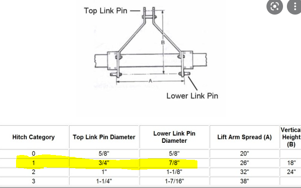

Hello all,
I picked up a box blade for my B7800 but found out it doesn't have the pins with it.
I need to order the pins, but the tractor is up at the property and I'm here at work for the week. Does anyone know what size pins I need for the two arms and the top pin?
Would like to get them ordered and bring them up with me on the next trip...
