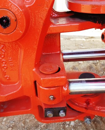

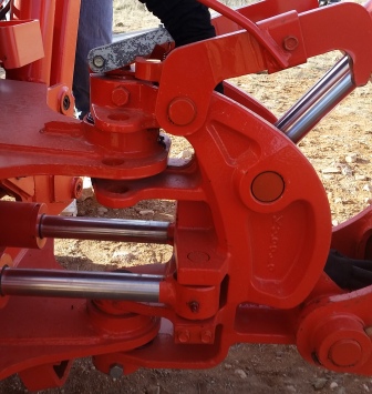

I've attached pictures of the bad and the good. My reasoning for taking drawings (from the Kubota parts website) is to give the shop a better clue as to the scope of the problem without having to lug a 150 LB chunk of steel around. Concur that some businesses won't have the tooling available to work on something so large and cumbersome while others might not be economically able to deal with something so small. I had no good clue as to how it might be repaired, but now thanks to all of your responses it seems that I won't need to write the check to Kubota. Removing it is likely to be a thrill, but life without at least a little excitement isn't really worth living.

Thank you for the pic. That helps me understand the problem much better. The area in question is not supposed to have any movement at all. The only part that is supposed to move is the hydraulic ram end where the grease zerk is. There should be a replaceable press-in sleeve in that ram that makes returning to factory tolerance a 30 minute job for one man once every 2000 hrs or so. Once movement started up there, it was already too late. The other side (the good side) didn't get any wear because it didn't have any movement. I wonder if the original source of problem was somebody failing to grease that joint and the pivot point siezed up so the bolt at the bottom of the pin slipped/broke?
I agree with your original assesment of the person who welded that washer over the problem. I also think you underestimate the weight of that block of cast iron. That's going to be a big job taking it apart. Take this picture with you to the machine shop before you start dismantling. They might be able to fix it in place by just swinging the hydraulic ram out of the way. Be sure to post back too. I'm curious about what they say.
