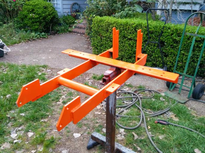

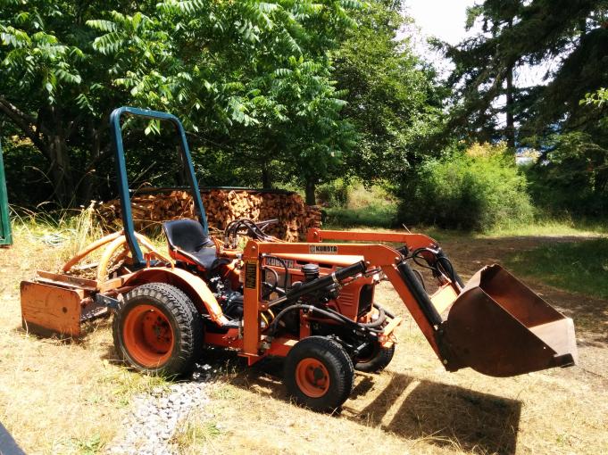

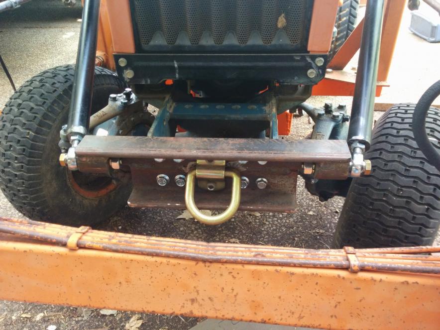

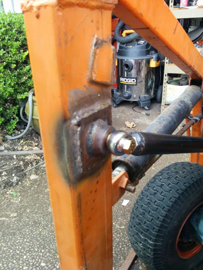

Here are some pictures of a subframe I made for my B5100 4wd. I remade the one that came w/ the FEL; it was supposed to fit my tractor but didn't.
Most challenging part of the installation was figuring out a way to drive the hydraulic pump, as the 18 tooth 21 mm spline fitting is unobtainum. Fortunately, a closely machined sleeve (hang wring fit, so say ~.0005" large) over the spline w/ a Shrink-Disk over it works like a charm.
Do watch out for tire clearance, and distortion due to welding during assembly.
Have fun!
