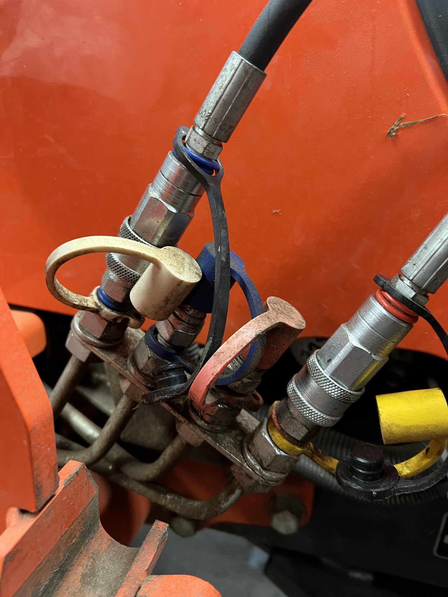

On the tractor (guessing) - -
  • Yellow and white - - that's a "Lift" pair, although may not be next to each other. Would also lift the blower.
  • Red and Blue - - that's a "Curl" pair, may be next to each other. They would rotate chute.
This is my tractor- a BX. May not be the same. I also don’t have any rotation, so I only use the lift pair.
The vantage point is left is rear starting with the white cap on the tractor. Yellow is most toward front, and "paired" with the white for hydraulic function. Blue then red are in the middle. They're also paired.
The blower uses the white/yellow pair, but note my hoses have small blue and red rings on both sides to correctly "orient" their connection to the tractor.
That way it lifts when I activate the lift function on the tractor, and lowers when prompted to do so. If I didn't have those rings and it worked in reverse, I would simply reverse the two hoses....everything works on mated pairs....
If I were to have chute rotation, that would use the red and blue connections on the tractor.
