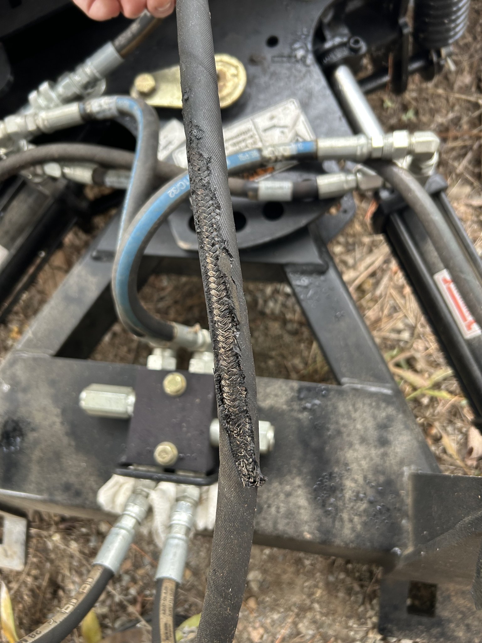

Patch hydraulic hose? Or replace?
Whitemike
Mar 24, 2022
17
Idaho
I have a few feet of 1/2" flexible hydraulic hose that attaches to a Land Pride STB1072 snow trip blade, it runs from the front of my L2501 to the manifold on the plow. The outer jacket has worn through from rubbing just on one of the hoses. Can I re wrap this spot with something or not fixable and needs to be replaced? The spot with the visible metal braid is ~12" long. Entire hose is ~30"
I agree with @JasonW. If you can live with the hose failing one day while moving snow, then wait until it fails. If you want it to look better in the meantime then cover it with some wrap. If you want to reduce further damage or don't want to damage a new hose, then secure the hose to the loader.
If it was just the rubber outer jacket, I would have no problem wrapping it with electrical tape or similar.... Done it many times.
However, In your case the inner braided steel reinforcement layer is chewed up.
My $0.02 .... Replace it.

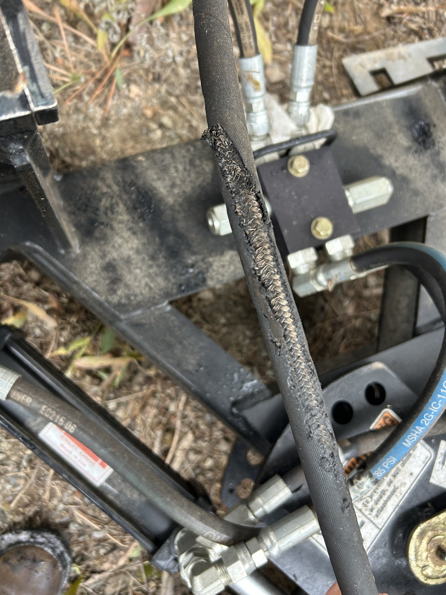

View attachment 166223 View attachment 166224
No brainer
7,962
3,253
Replace.
