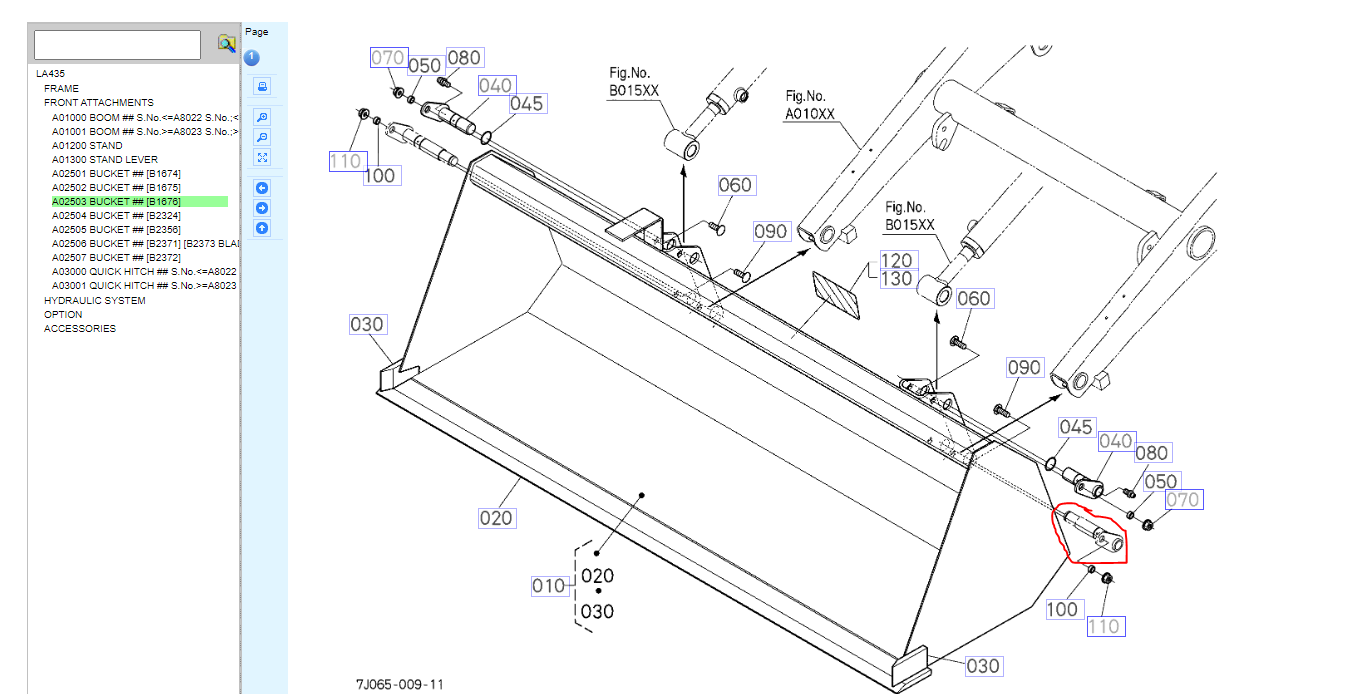

I broke a grease fitting in one of the pivot pins on my loader (LA435). So I guess I need to replace the pin. Problem is I can't find the part number.
The diagram doesn't list a part number. Anyone can help me identify this? part circled in red.

curious was I, looked it up...
if you chose the 'SSQA style'..) drawing 'A03000', there's a pin # 210, that might be it.
My idea is that pin will be the same as it fits the loader arm ??
No, it's not #210. On that drawing, it's the pin with the line going to the figure number. So still unidentified :(
