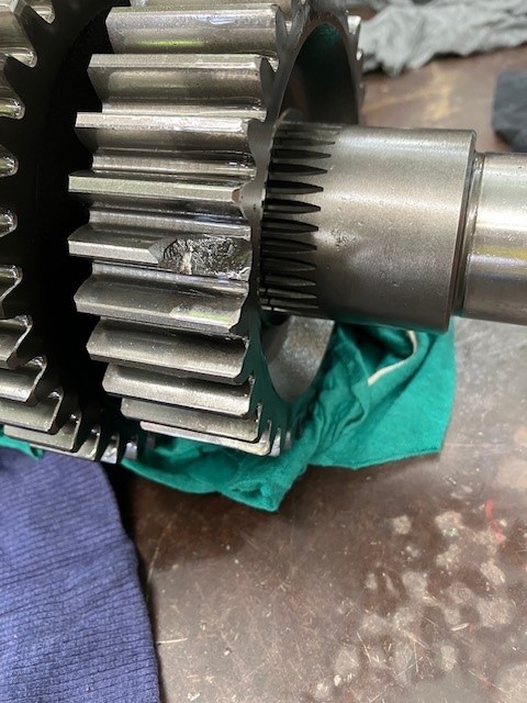

Had similar damage happen in our 9540, see pics, i cant seem to see the pics from previous post by Bcancienne. Our tech reckons this is caused by slamming the park brake on whilst in motion? didn't think it would be allow it to be activated when moving? any thoughts
