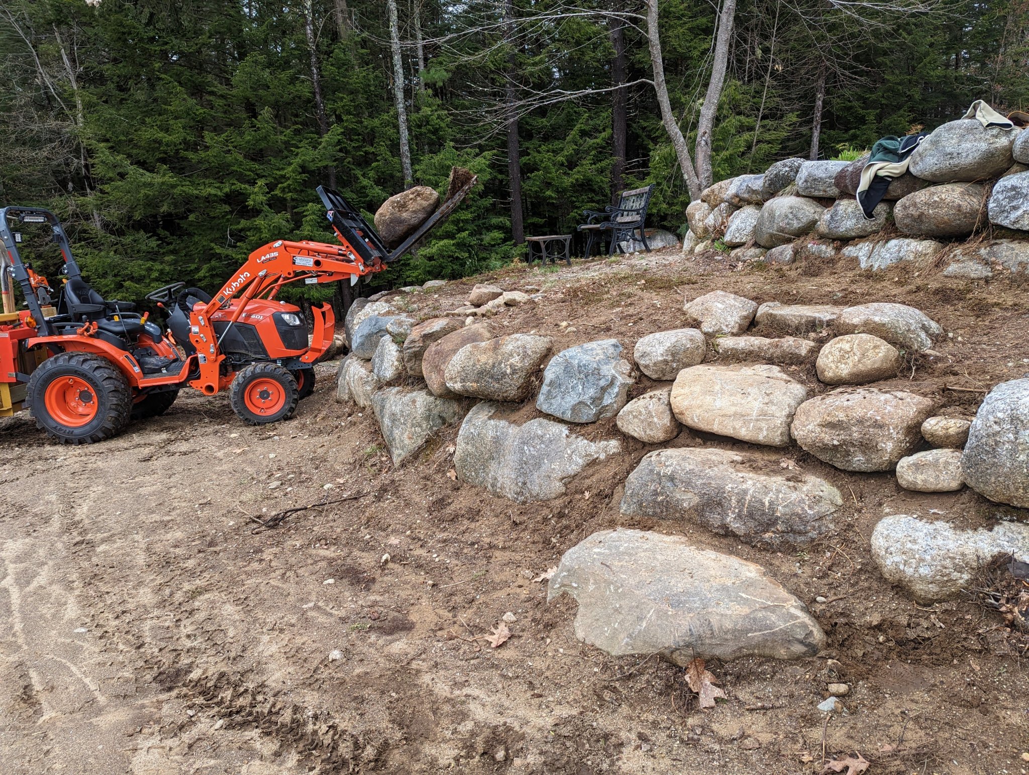

I have a B2601 and I purchased the EA forks with the armored tips. Took a couple months but that was the winter anyway. Within two weeks I have used them to remove a rock necklace around my field (not a wall, just single rocks that looked silly to me and done in the last 20 years) and to build steps into a terraced wall. These are New Hampshire glacier rocks, not little Mid Atlantic stones. Based on machine resistance and volume, 700 to 900 pounds each. Some barely all the ground. I figure I can an extra 200 lbs lift (weight of fork attachment) by rigging slings directly to the adapter plate on the tractor.
Then I used a single fork as a powered digging bar (38 inch reach) to make digging some footings for a pole barn much easier.
Downside: paint is scratched.
