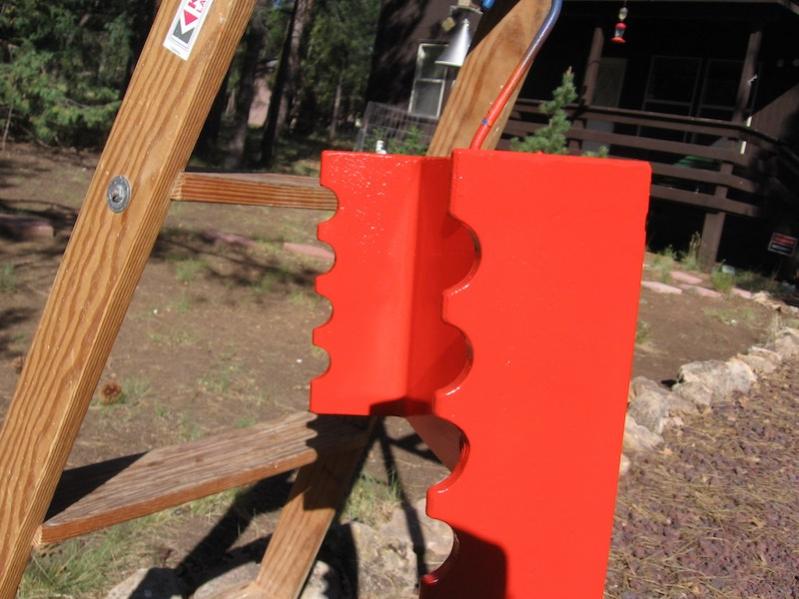

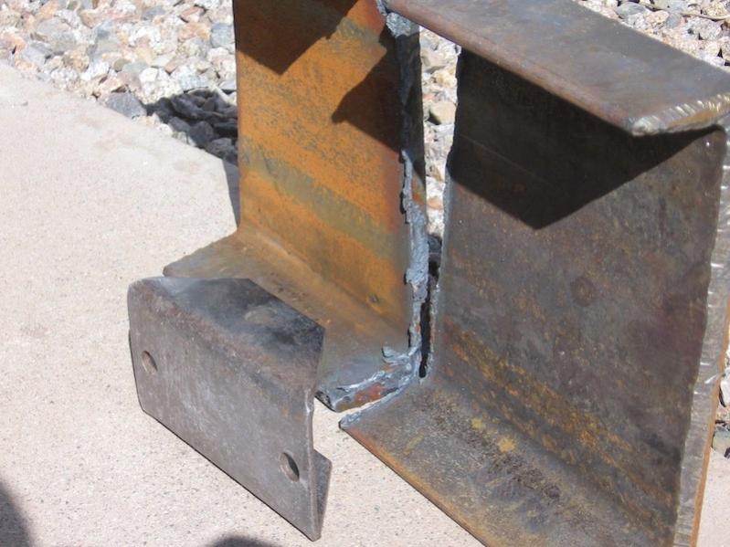

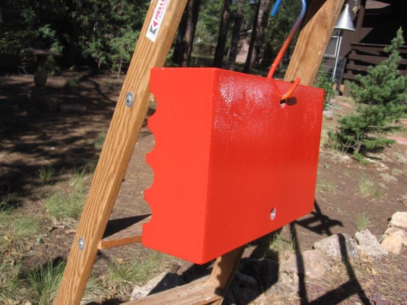

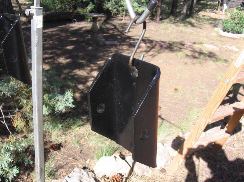

The stabilizer pads on my B670 have always been woefully inadequate, skating around like Bobby Orr. Passing by a construction site, I spotted these cutoffs from some 12" x 3" x 1/2" channel, and asked about them. After some confusion, (the guy thought I wanted two 21' lengths) he graciously gave them to me. After some machining & painting, I now have the most stable B670 on the planet- they worked even better than I expected.
First two pics show the raw material, & the stock stabilizer pad.

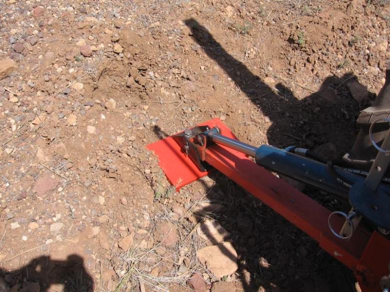

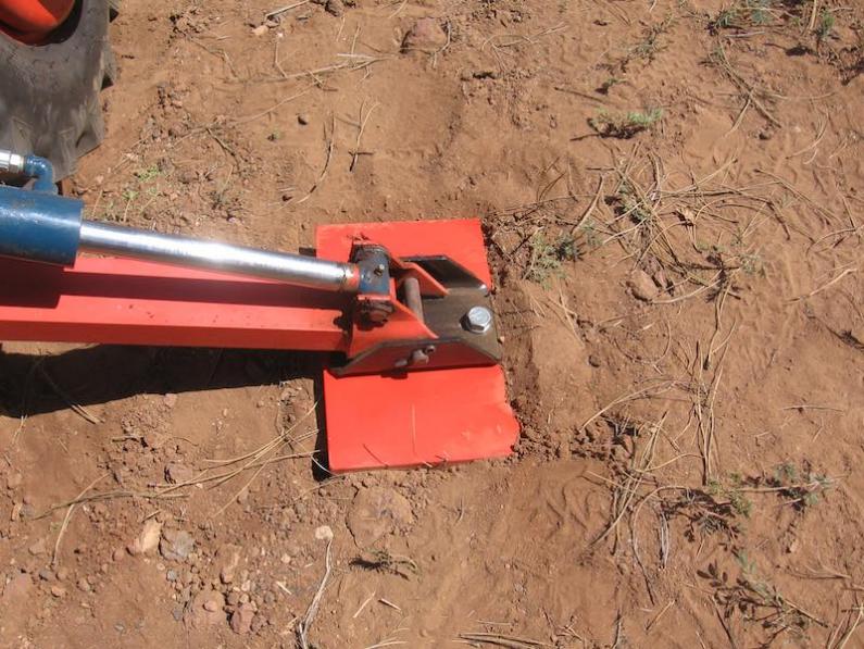

Finally, in the field. The new pads measure 12" x 7 5/8" x 3". These pics pics were shot after 40 minutes of digging in hard pack dirt & clay with some rock, with no re-positioning.

Excellent! How did you cut the serrations in the channel legs? If you did those with just a grinder, you're way better than me!
First I squared them up. (flame cuts were not straight!)
I clamped the two channels together together, open side to open side, stood them vertically on the mill, clamped them to an angle plate, and found the centerline between the two halves. Then I calculated the spacing, center drilled & drilled four 7/8" holes, then opened them up to 1" with a roughing end mill. This left "half a hole" on each part. Then I just flipped 'em & repeated the process on the other end.
Ended up with half a dozen 3/32" x 3/16" minor burns on my arms from HOT chips, and one above my right eyebrow. Lots of steel needed to be removed, both for the "half holes" and to square them up.
