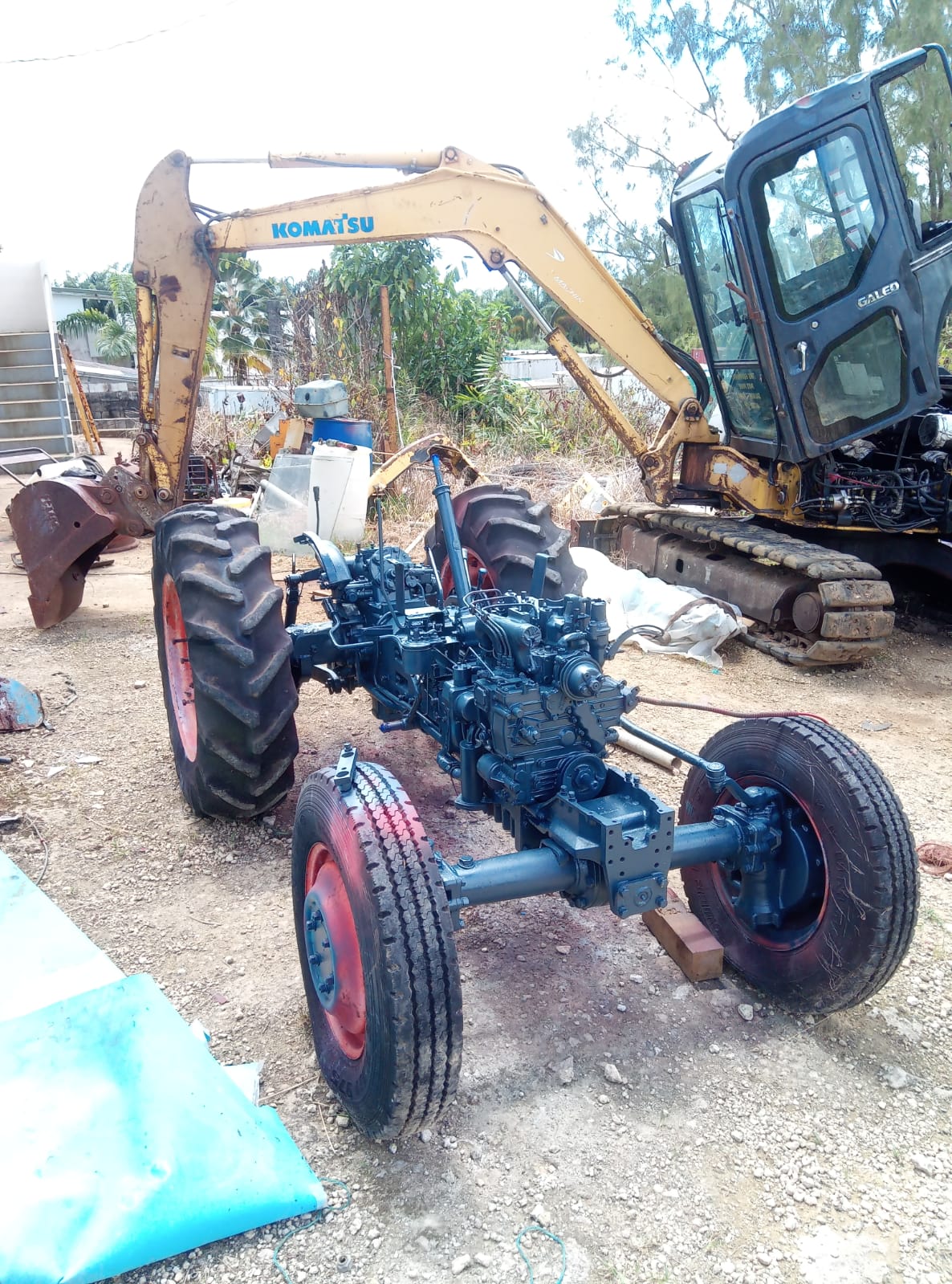

Another source of limiting the airflow over the radiator is a clogged screen in front of the radiator or some clogged heat exchanger that is in front of the radiator. On my tractor the battery is in front of the radiator blocking off some flow. Just be sure that you have a clear path into the radiator fins since you know the radiator is clean on the outside. It might be clogged upon the water side but that is lower probability since you see good flow of the water.
Edit: now I saw your pictures so ignore the comments on clogged screen

No, when we got the tractor it had been put down because the rear axle seals were leaking, sat for so long that every body panel and sheet metal component wrought off of it.
Can you find another radiator about the same size or bigger and use it as a temp test unit?
