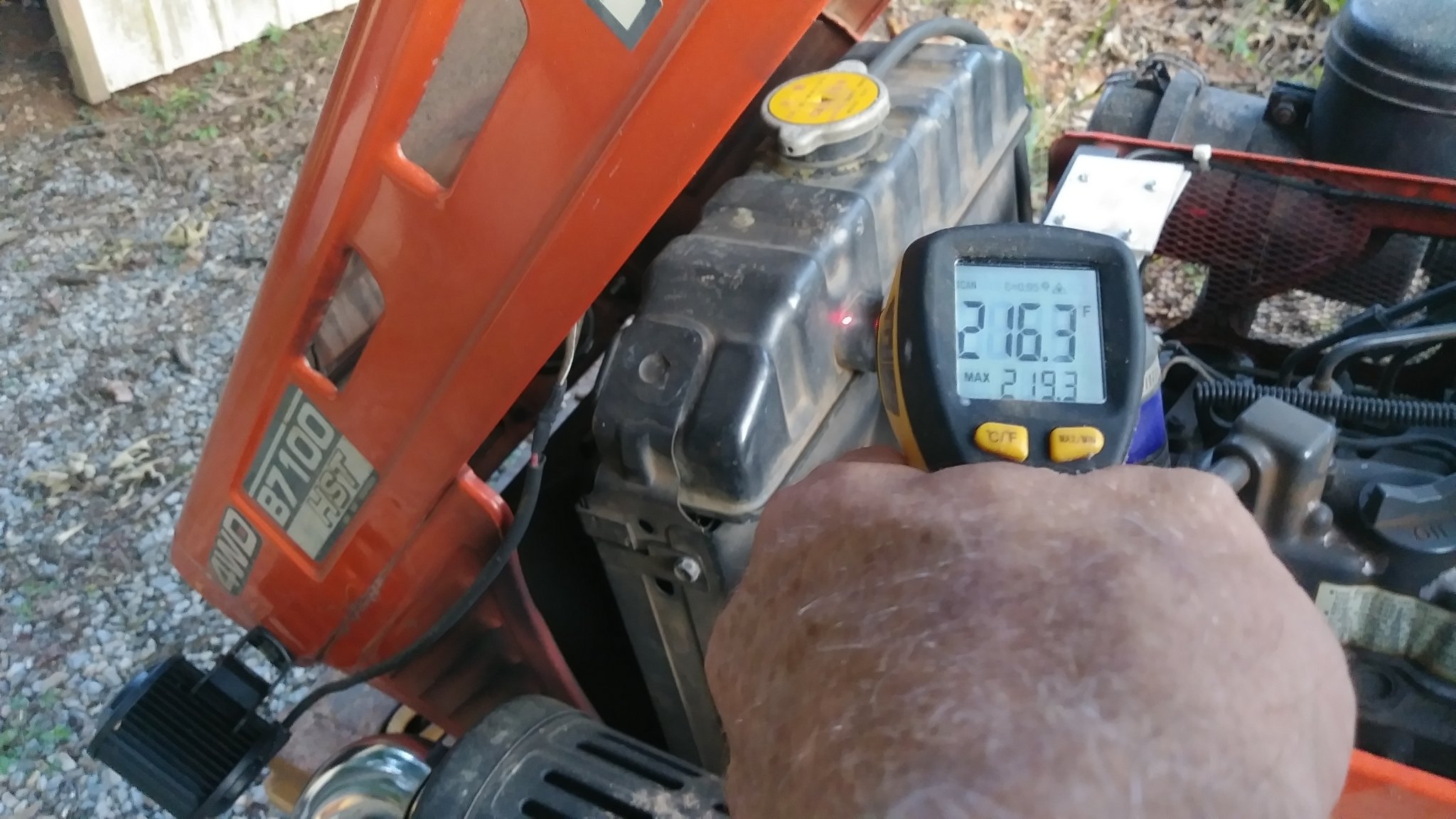

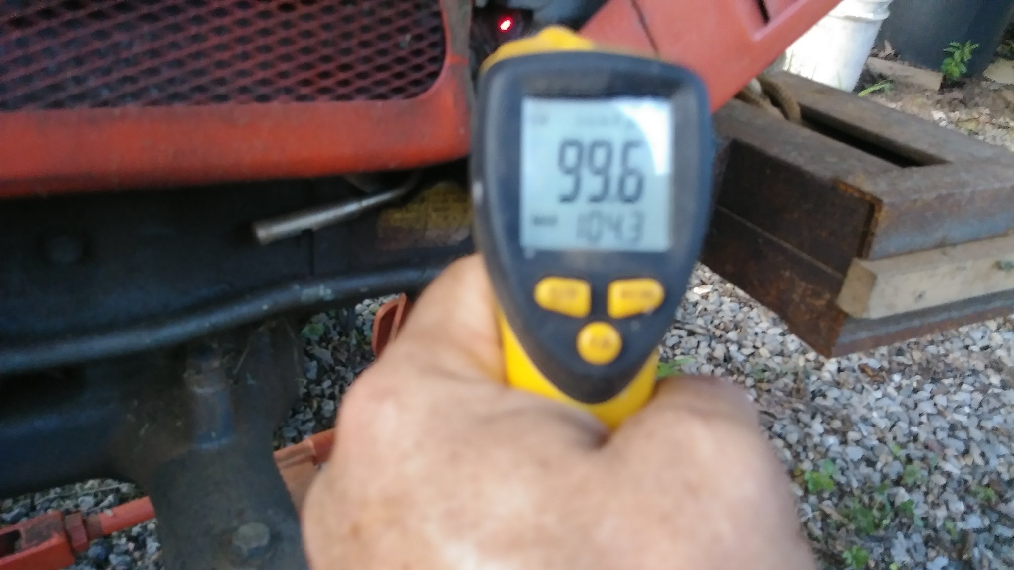

can you take readings with an infrared thermometer? top neck on radiator and then bottom neck of radiator. This will tell a lot.
