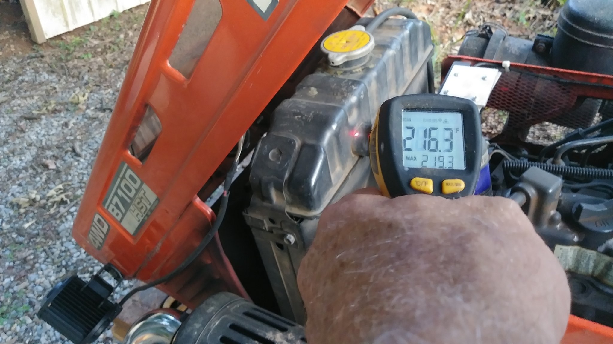

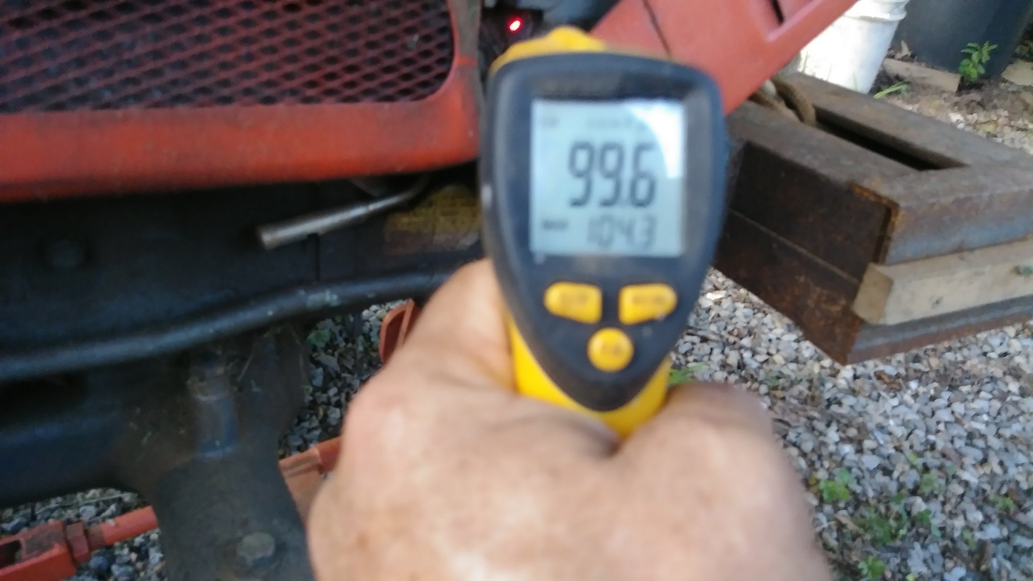

Get you are infrared thermometer - run it like you did before and check several spots and tell us "how hot" it is really running - check top and bottom necks of radiator too.

Top reading is right at the hose neck and bottom reading is lower neck on radiator

I took a temperature reading of the top and bottom of the radiator where the hoses come out. After running hard the top was at 256 degrees and the bottom at 112 degrees. Definitely steam coming from the top of the radiator through the cap. Some spray of coolant on engine block. Are these normal radiator temps?

Well - based on your numbers, the radiator is working very well - a drop of 100 plus from top to bottom is excellent - however the 256 is NOT good !!! That's about 40 degrees too high.

The 256 is above the boiling point of water at 13 PSI. So too hot for the system to deal with. I would replace the radiator cap and see if that resolves the issue (but that is doubtful)
Correct. It is even above the boiling point for a 50/50 mix (water, coolant) at 15 psi.
So....clearly the temperature taken (at top) was the latent heat of the steam being produced.
I agree.....replace radiator cap first thing.
