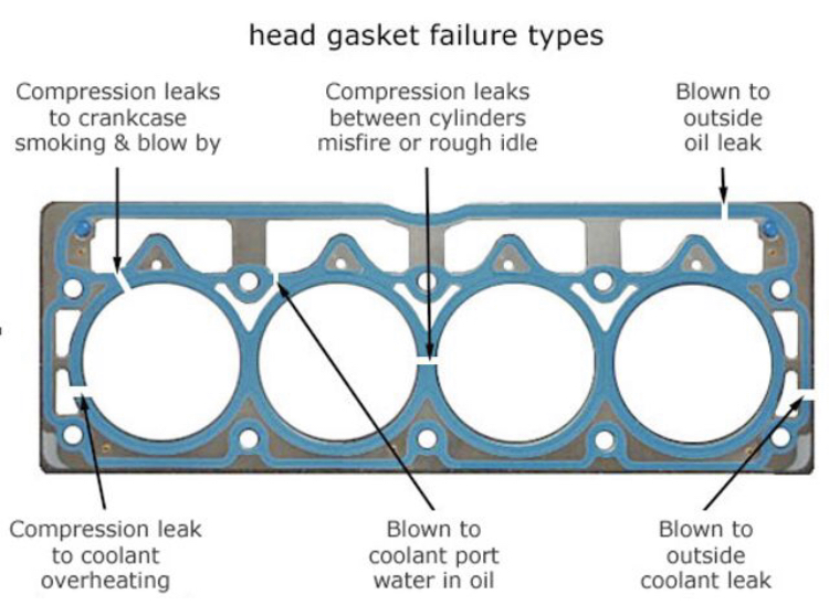

rather doubt the head gasket as no fluids are being mixed.....
Though HG failures often manifest that way (fluid mixing) it is not the only way a HG can/will fail.
A steady stream of bubbles in the coolant upon start up is a near sure sign of Head Gasket failure (compression to coolant).

based on your last sentence ........ " if and when it bubbles. It starts a small but steady stream of bubbles about 10 to 15 seconds after starting "
I would say you have a blown head gasket - your BIL should be able to help you fix it - need some simple tools and a torque wrench. A leak at the right spot on the gasket will pump combusted air into the coolant
and show up as bubbles in the radiator.
