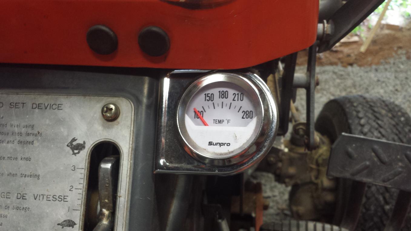

Tooljunkie is exactly right - electrical units will need the ground - and also as he said - top hose too - where the heat will be. I thought about placing one at the bottom too - but that thought was short lived......hell you cares how cold it is, I want to know if it is getting too hot !
I bought another top hose from Messicks- I didnt like how the factory hose was going to work, the factory hose is a long sweep of an arc, where the replacement is more of a 90 degree.
On the B7100 there is not a lot of error room where to cut the hose- I have about 1/4 from neck to neck on the bottom and the turn comes into the top of the adapter slightly - but no leaks and it works well.
I will send you some pictures tomorrow!!
:D:)

Jay,
here is the picture I promised you :
the grounding screw is right below the other wire. Both wires run back via the wiremold. The gauge was easy to mount also - and I decided on the right side over the left - since most of use get on the left side first - much like a horse or a FEL with long joystick getting in the way.

Jay,
Great thanks for the pics thats the exact sensor housing I bought. I will install it like you.
