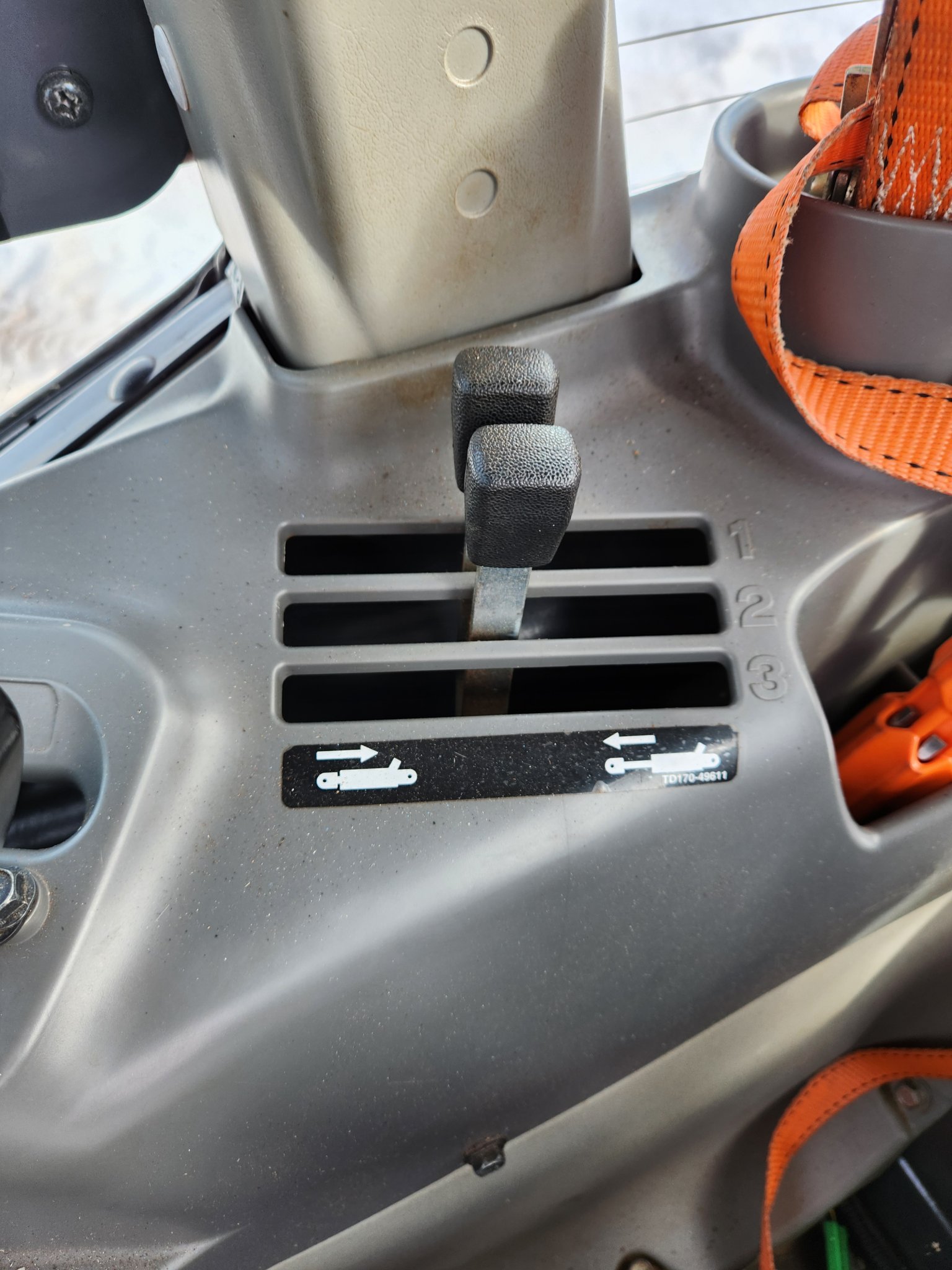

I have a Kubota L3540 and would like to use a wood splitter using the existing hydraulic system.
I have 2 sets of remotes. I would like advice on how to configure the controls so I can use the splitter.
See the attached photos.

I am looking for advice on the positioning of the Remote Hydraulic Controls so that the Control valve on the wood splitter will work.

I think you need what is called a directional control valve to divert the full flow to the splitter.

Use a bungee cord to hold the valve open.
You're not going to be happy with the rate.
It will have plenty of power just no speed.
Exactly! You will have to find a way to hold the remote valve lever in one direction or use the power beyond connections if you have them. The speed of the splitter will be in direct relation to the engine speed and gpm available from the tractor. These are positive displacement pumps, so the output is directly related to the engine speed and pump displacement. I have a 4" cylinder on mine operated by a 11gpm PTO pump. I have to operate the engine around 2000 rpm to give me a comfortable splitter speed. Mine obviously has its own oil reservoir etc.

I see now. Probably the cheapest way would be to add a third line to the manifold under your seat. It has an inlet/outlet for it. You'll get the maximum flow available.

You can probably use either rear remote. Just wedge a stick to force one of the levers to be 'on'.

I hsve bern using a 3pt splitter for 20 years and your remotes are most definitly not the best way to do this. You want to setup a continuos flow outlet. Its not hard or expensive and there are multiple ways to do it. Do you have a loader or backhoe on the tractor?

Just put a quick coupler on the PB line coming off the loader valve. Use it to connect the log splitter. No bungee and you eliminate the remotes.
