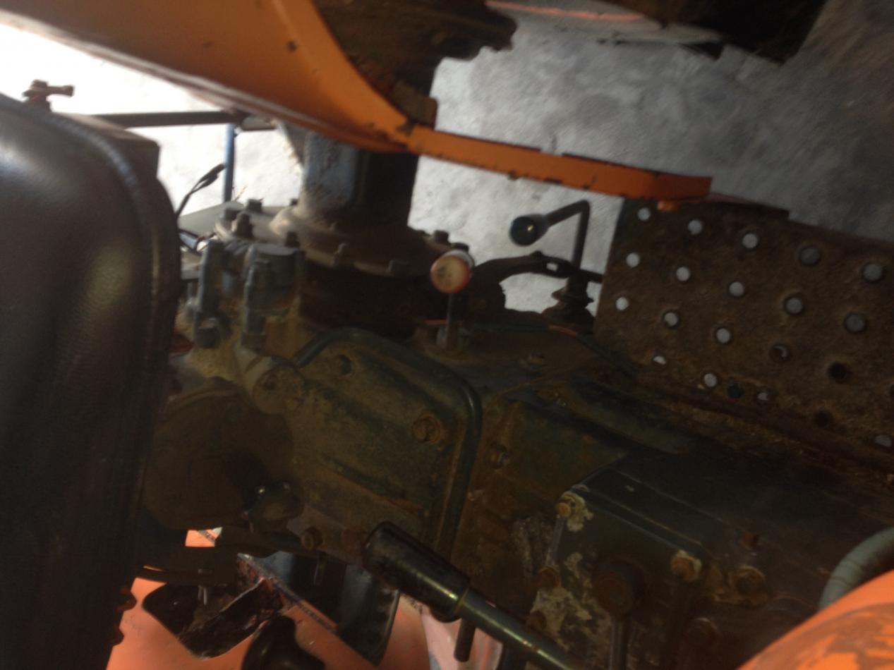

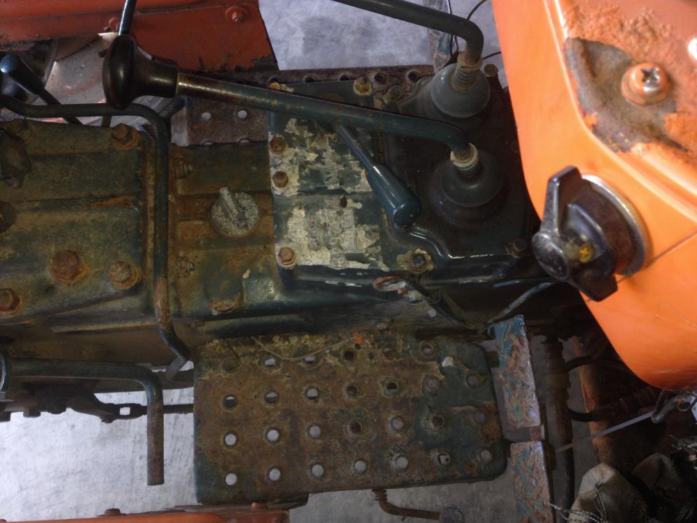

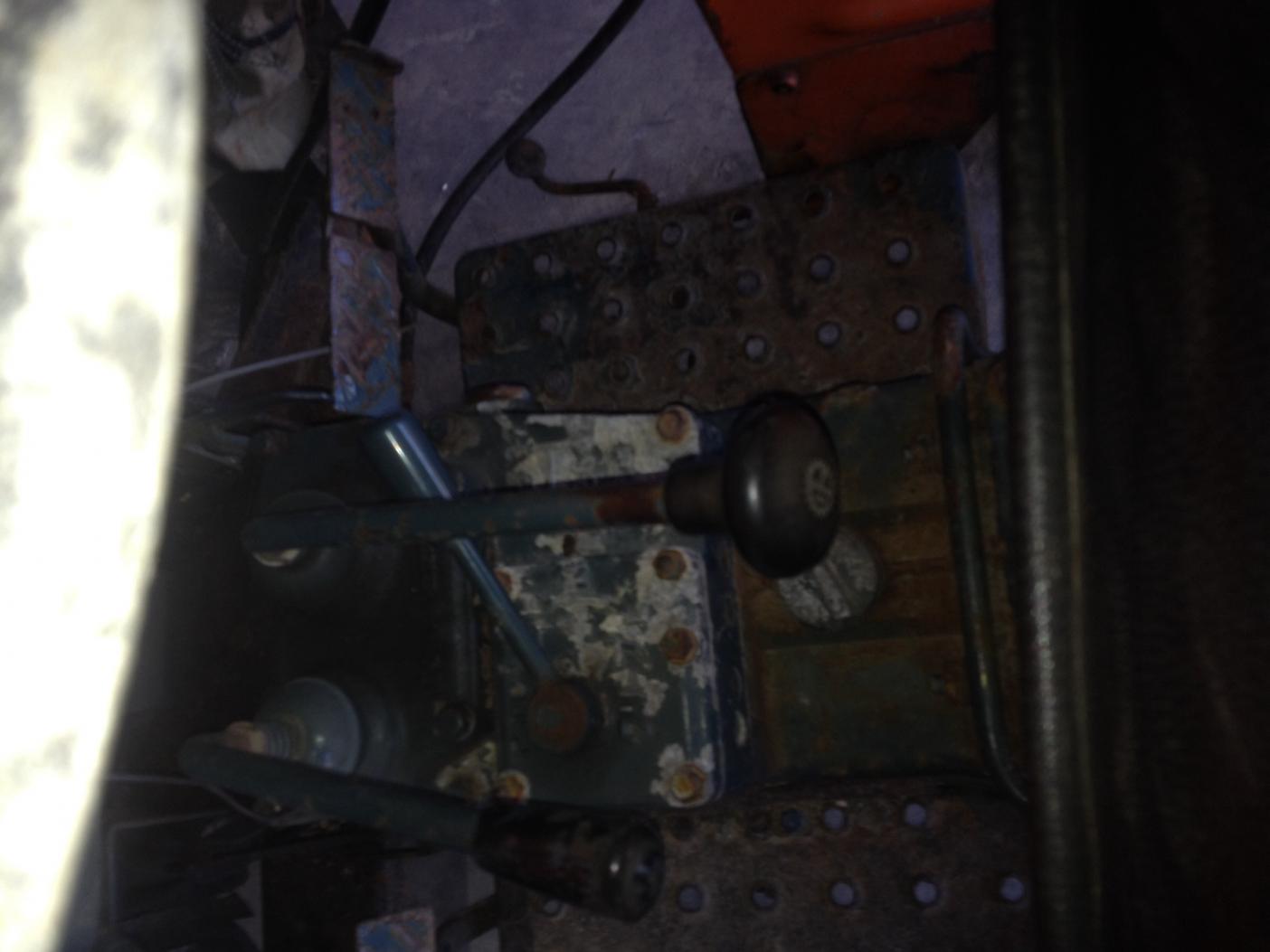

I took a few pictures of the shifters this morning before work. Sorry the pictures kind of suck, It was pretty dark in the shed.

The shifter on top of the transmission mounted sideways is your creeper gear. It's a second hi/low range and will drop you into super slow speeds. The red handle by your seat should be the main hi/low shifter. And the other shifter next to it should be for the 4wd :D
Are you sure it's not an l1501dt instead of an l185dt? Check the tag on the side of the transmission by the clutch pedal. Should have a serial number, model number and horsepower rating

Looking at your pics and remembering my old L185dt
Top of tranny on mine was F/R to the left
1-4 on the right
and the small lever was for the PTO speed 1000 or 540 RPM
To the left side were the 4x4 lever the smaller one
and the Hi/Low the longer one
Been 3 plus years since I had it but that is how I remember it
