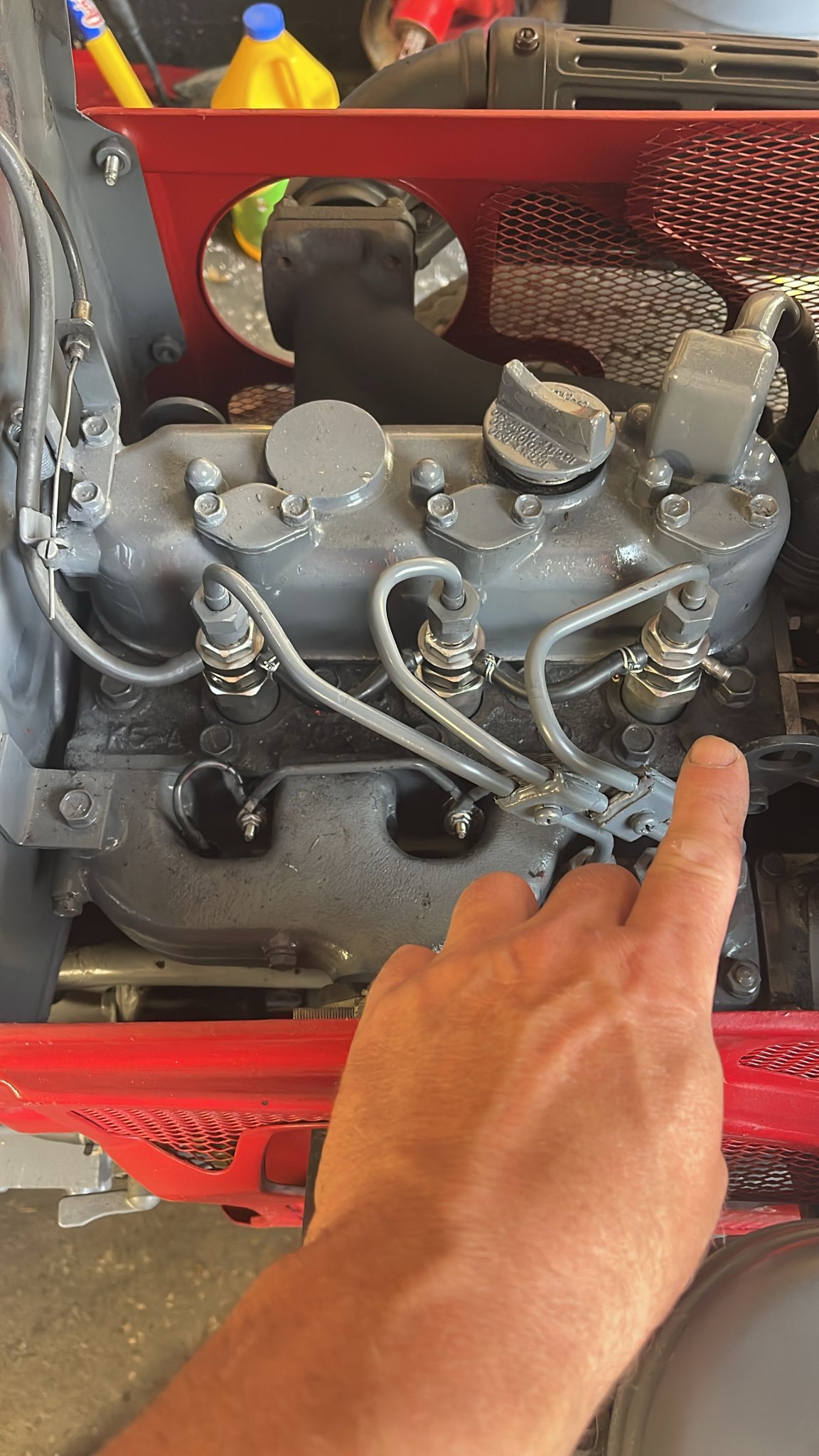

To my knowledge - there is only ONE return line to the tank. You may need to nipple that off. Rubber stopper.
6,412
2,047
The FRONT injector should only have one overflow tube not two. This is an example
You may be able to get a cover and use the same clamp as the hoses. I guess you could use a hose and clamp it off or TEE it into the hose going into the tank.
