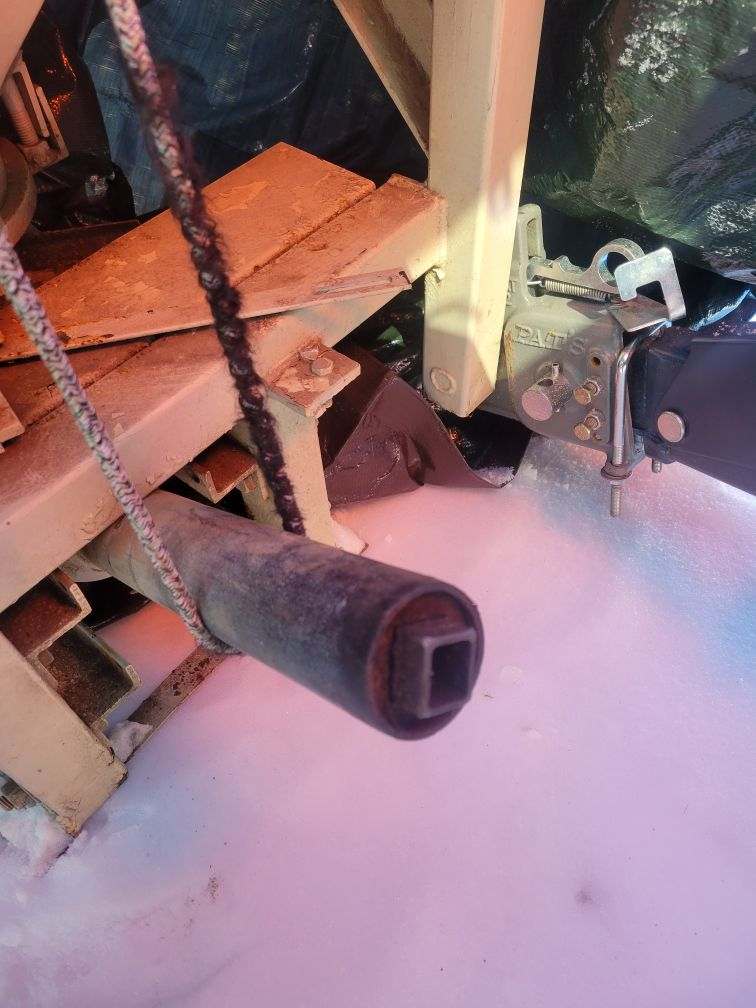

Yes you can get square pto shaft parts. Bothe male and female ends. I would measure it first as they do make rectangular sliding shafts as well.
But by the time you get that figured out you could probably buy a new shaft from Amazon and replace it. Just need someone who is skilled with a cutting torch to get that yoke off the other shaft.
Of course pics and measurements would help.

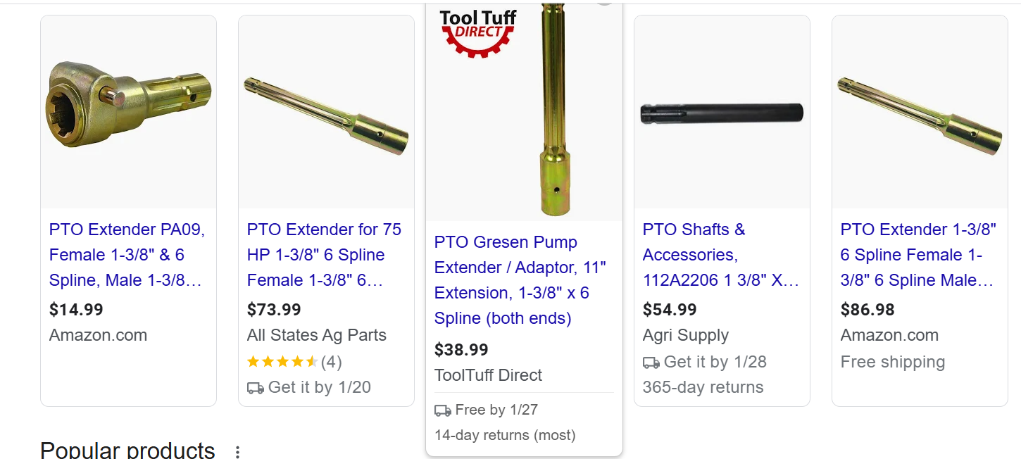

This might help you get your head wrapped around this - but you probably already know this.
35,040
10,277
I can buy that rectangle PTO shaft at the local farm store.
I looked around and a lot of places sell the shafts you just need to know the measurements.
But if you can't buy a longer shaft, I don't recommend these, but they are all sold.

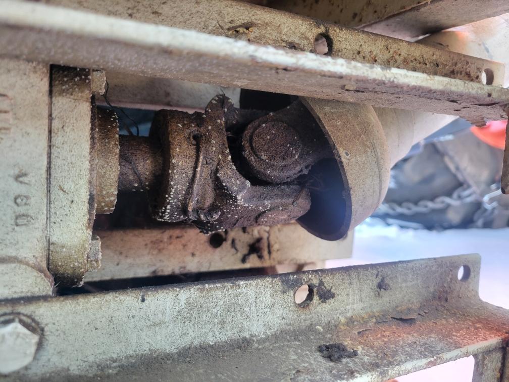

Thanks gang. Ran around all day to Kubota dealer, TSC, and called Kasco Mfg (maker of Herd spreader). Paula at Kasco was very helpful and knowledgeable. Turns out the PTO is rectangular and the spreader side is bolted to the shaft of the implement gear box with no "easy-off" collar. The tractor side has the usual detachable collar. Picked up PTO shaft extender and overturn clutch as was suggested here at TSC but neither works as L6060 PTO shaft has no through shaft hole to securely attach these devices. So, at this point, seems like the best solution is to order a PTO shaft from Kasco. Need approx 34 inches to link tractor and spreader. Thanks again for all the helpful input guys. Guess I learned a lesson.... buy new next time, lol. This tractor has been giving me quite an education.

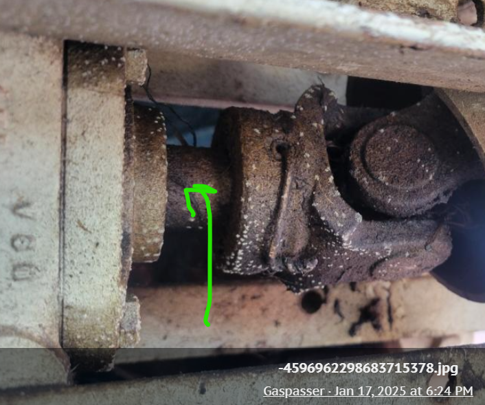

Your really over complicating this, the rear coupling is a standard round shaft pin on coupling, easily replaceable.
You could buy a standard PTO shaft and replace it.

Thanks Wolf. Relative newbie here so over complicating tendency due to my ignorance. So, if I'm understanding you correctly, I can detach the universal joint from the spreader gearbox and use standard PTO shaft as you cited, Wouldn't I have to get a pin on universal joint with splines to attach to the gearbox shaft so that the PTO shaft has a compatible attachment point?
Measure the diameter of the shaft (green) and give me the length and I'll point you to the shaft you need.
