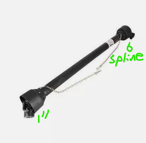

I'm really confused why you are ignoring my posts on the adapter and shaft that's way less money that what your posting?
This is really the best option:
Bolt it on and your done:
But if you want to adapt it:
This fits the shaft on the spreader.
Yes you will need to drill the cross hole since you don't have a keyway.
And this shaft is long enough because the adapter adds 5 1/2 inches to the length.
