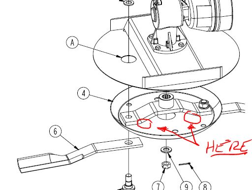

One thing I didn't read above: Never sharpen bush hog blades to a fine edge. It's a waste of time and weakens the blade. Leave about 1/16" of flat face to impact point. My RCR1260 manual states this and it's meant to keep a strong face to the high velocity impacts. Bush hogs are finish mowers so they aren't set up 'sharp'.
I don't know about the 1860, but on my 1260, I have to keep the jumper disk area cleaned out on a regular basis or it throws the assembly out of balance.

ShaunRH, you brought up an interesting subject for me. I've got an old LP RCR (?) 1560 rotary mower that gets buildup between the jumper disc and the top deck. Left too long it throws off the balance. I've never had that happen on other mowers.....my new 6' LP 2072 doesn't. On the old one the disc is very close to the deck surface, the newer one has more clearance. I'm guessing the clearance (or lack of it) is the culprit.
It's a design flaw. They make the assumption that whatever you are cutting will be ground up enough to not jam up at that point, but if you are going into growth that is several years old, it's an invalid assumption. I do not have the problem in areas that I have maintained before, but in the long, deep stuff, it really jams up! I'm probably going to eventually weld in some V shaped plates to cover the drop down area so it won't plug up. It will also improve airflow.

Shaun, same here. The larger "stringy" type vegetation is the worst. Hasn't been terribly difficult to remove through the hole in the deck, just aggravating!
