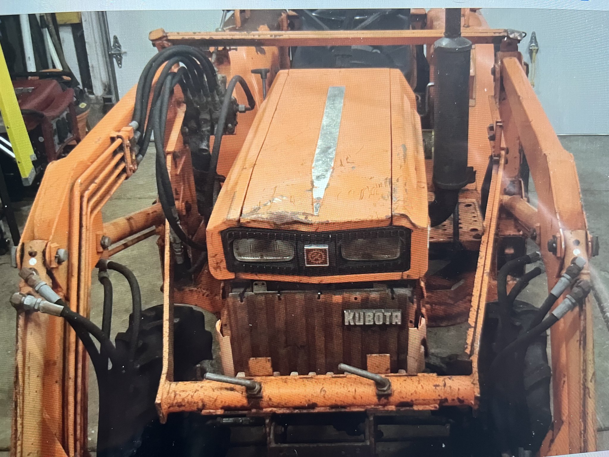

I’ll take some pics and post them in a few days,your description of them sounds right.
The two bars you're talking about, do they have a square end on one and flat plate on the other? If so. those go in the hole at the bottom of the loader towers to hold that end up during storage.
here is a pic from the day I bought the tractor, it needed somerepairs and cleaning.
You can see the arms for the bucket across the hood , but , there are two other arms inside the left loader arm.
I’m not sure what they are for?
14,418
6,711
When you remove the loader you remove the nut with the lever welded on, one on each side. The tower base will have a hole that fits the end of those two rods. The end with the base sets on the ground surface to hold the back of the loader up.

This post shows the process for removing loader. I put a wood block or brick under each foot so it doesn't sync into the dirt over the winter.
