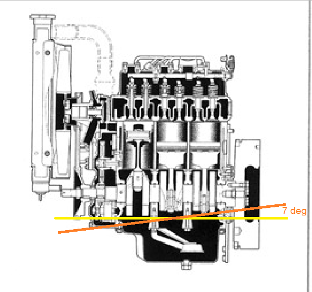

... is the dipstick tube original (not the sort that normally goes down through a hole in the block) or the right length for that dipstick?
Didn't get any bites on that question, so took a brief look at a D950 parts list which indicates that you don't have the standard dipstick arrangement. So the tube and dipstick is probably a special, maybe borrowed from a different series Kubota. The D950 (anyone, correct me if I'm wrong) has the dipstick hole nearer the front of the engine. Relocating it 1/2 way back makes some sense for a tilted engine. That oil level would have to come down a loooong way to expose the oil pickup (which according to the diagram I saw is towards the rear anyway) so that shouldn't be a problem. I reckon think about Wolfman's question about oil quantity, and depending on that, consider operating the engine with a lower oil level and keep an eye on the oil temperature as well oil pressure.
Don't know if the yellow line correctly shows the standard oil level (below the line of the counterweights), but operating for an extended period with a 7 deg. tilt might causes rear counterweights to whip up oil. And when your boat is cruising, does that change the angle further... bow up, stern down? Just my 2c.
[edited to add question about change in boat/engine angle when cruising]
Thank you sir, yes the boat angle changes a lot with rocking and yes like you saw the dipstick tube is a marinized thing on this engine because the modified exhaust manifold blocks the standard dipstick location. I brought the oil level down to half way between full and empty...which really should still be ok anyway, to see if it makes a difference and will test in next few days. Like you said the oil pickup is way lower in the pan and the designer who marinized prob went very conservative.

... yes the boat angle changes a lot with rocking ...
Not thinking so much of rocking, but the sustained angle at whatever speed it can spend a lot of time at.
Oh gotcha, nothing like that, its a sailboat and maximum speed is around 7-8mph with this engine, which doesnt change the angle by any significant amount. This engine was used on tons of these boats and has a very healthy online community but this topic only ever leads to oil sensor or cam plug issues unfortunately, nothing like all the ideas raised by the great comments in this thread by everyone.
